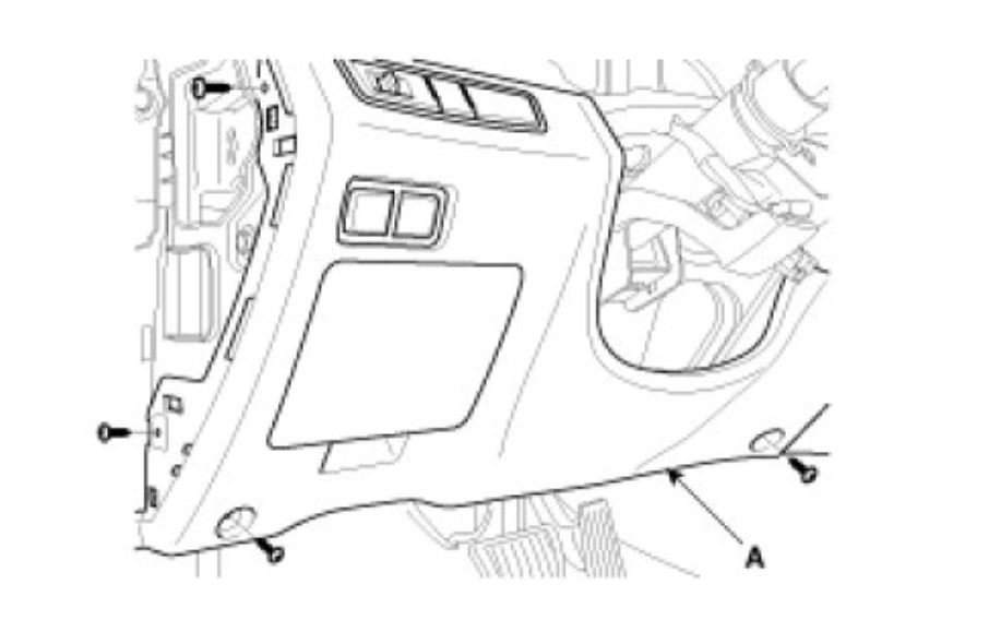

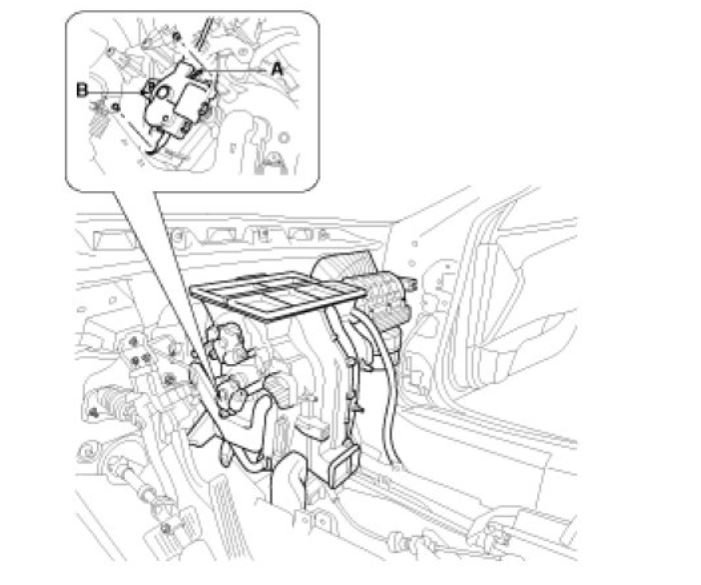

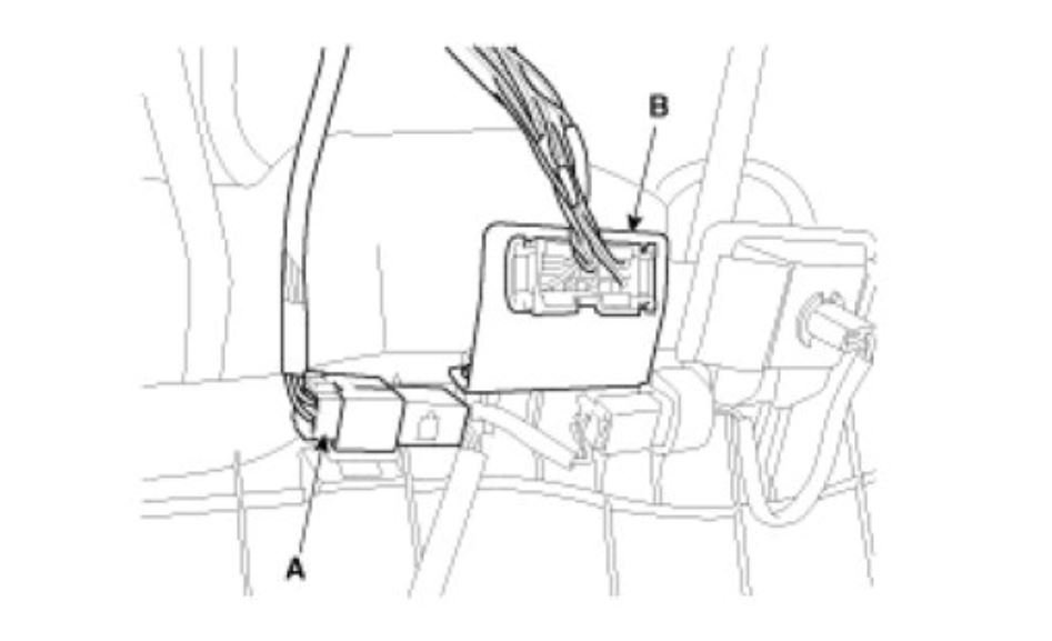

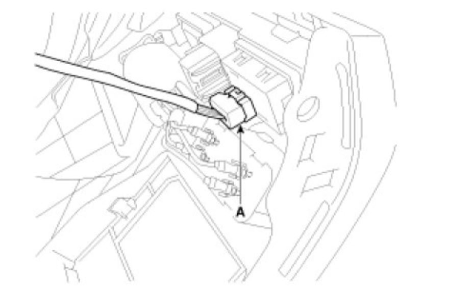

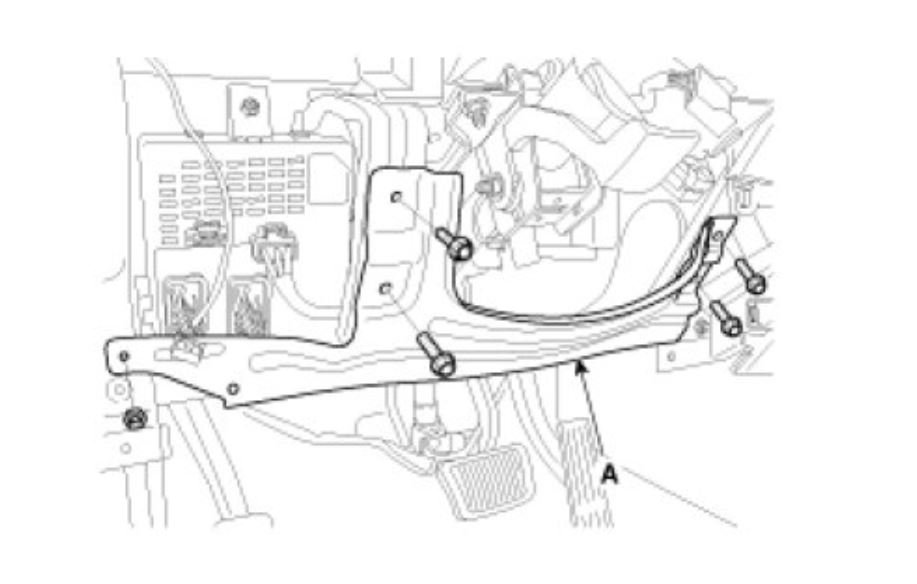

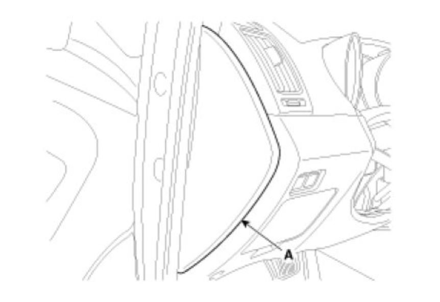

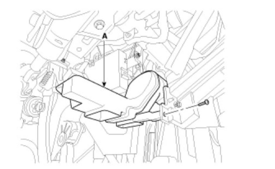

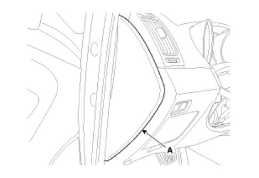

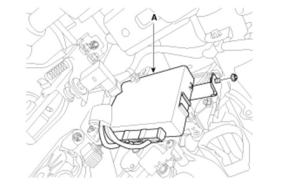

Need to replace, no diagram. The passenger side blows cold air the driver side does not. Do you have an idea what the problem is?
Jun 7, 2018 at 12:08 AM
Good afternoon.
Procedure and pictures below for your repair.
Replacement
1. Disconnect the negative (-) battery terminal.
2. Remove the crash pad left side cover (A).
imageZoom/Print
3. Remove the extension cover.
4. Remove the crash pad lower cover (A).

5. Disconnect the connector (A) & diagnosis connector (B) and then remove the crash pad lower cover.
imageZoom/Print
imageZoom/Print
6. Remove the reinforcing panel (A).
imageZoom/Print

8. Remove the BCM (A).
imageZoom/Print
9. Disconnect the temperature control actuator connector (A).
10. Loosen the mounting screw and then remove the temperature
