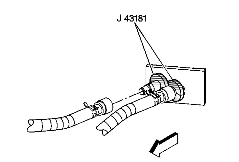

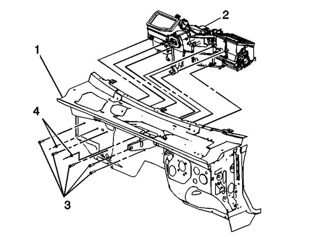

Good morning,
I attached the procedure for removing the housing for you. I attached some pictures as well.
Let us know if you have any other questions.

1. Drain the engine coolant.
2. Using the J 43181 disconnect the inlet heater hose from the heater core.
2.1.Install the J 43181 to the heater core pipe.
2.2.Close the tool around the heater core pipe.
2.3.Firmly pull the tool into the quick connect end of the heater hose.
2.4.Firmly grasp the heater hose. Pull the heater hose forward in order to disen(gauge) the inlet hose from the heater core.
3. Using the J 43181 disconnect the surge tank outlet hose from the heater core.
3.1.Install the J 43181 to the heater core pipe.
3.2.Close the tool around the heater core pipe.
3.3.Firmly pull the tool into the quick connect end of the heater hose.
3.4.Firmly grasp the heater hose. Pull the heater hose forward in order to disen(gauge) the surge tank outlet hose from the heater core.
4. Remove the accumulator.
5. Remove the instrument panel carrier. See: Dashboard / Instrument Panel > Removal and Replacement
6. Remove the HVAC module drain hose.
7. Disconnect the electrical harnesses and the ground connections from the HVAC module.
8. Remove the nuts (4) from the HVAC module (2).
9. Remove the bolts (3) from the HVAC module (2).
10. Remove the HVAC module (2) from the vehicle (1).
