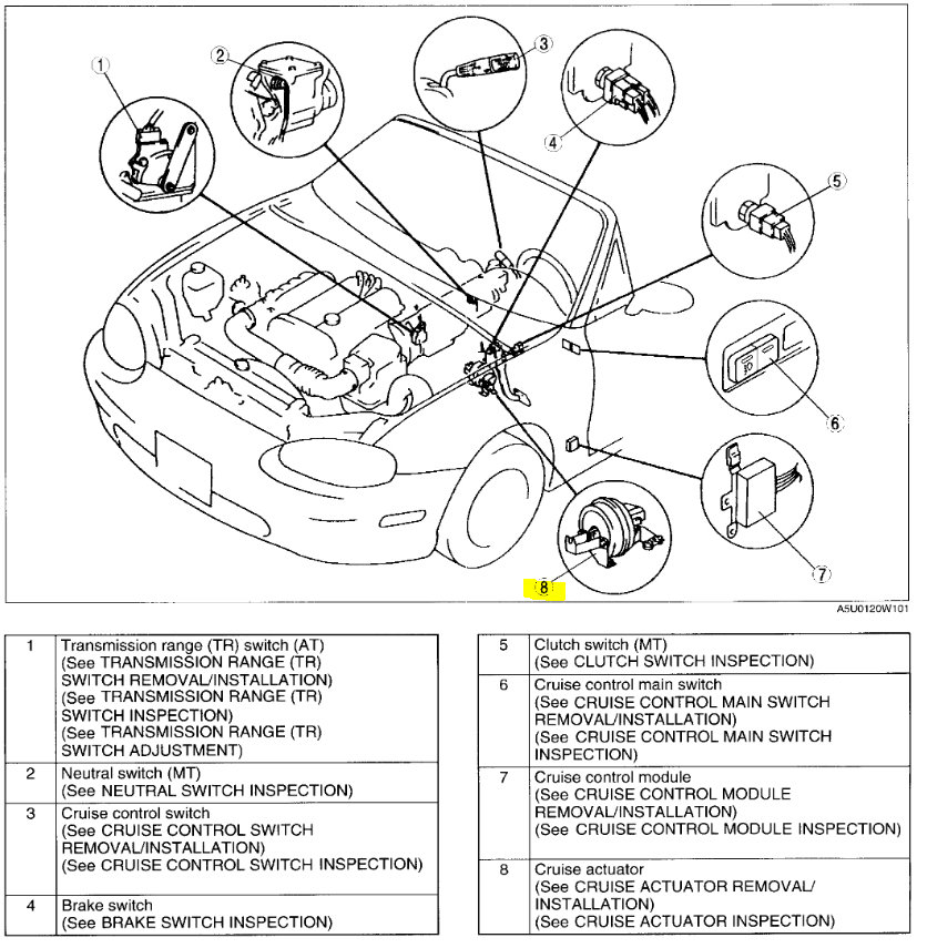

Location of cruise Actuator.
Apr 24, 2022 at 10:11 AM
SQM
Experienced Mechanic
6,383 POSTS
The cruise control actuator is located behind the brake pedal.
See diagram below.
Check out the diagrams (Below). Let us know what happens and please upload pictures or videos of the problem.
