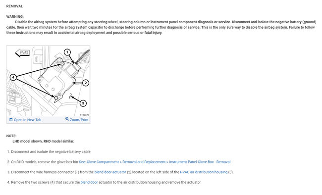

Clicking noise when I put it to a temperature. Are there three actuators? can’t find the third one, I found the two behind the glove box.

I attached the procedure and location of the blend door actuator. When you get the clicking when changing temperature, it is the blend door actuator. It is behind the glove box.
Let me know if you have any other questions.
