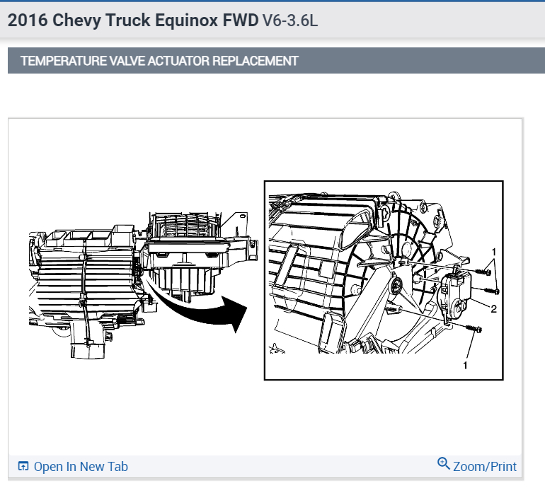

where's the blend door actuator located on the passenger side?
Aug 31, 2023 at 3:29 AM
  • 55,721 POSTS

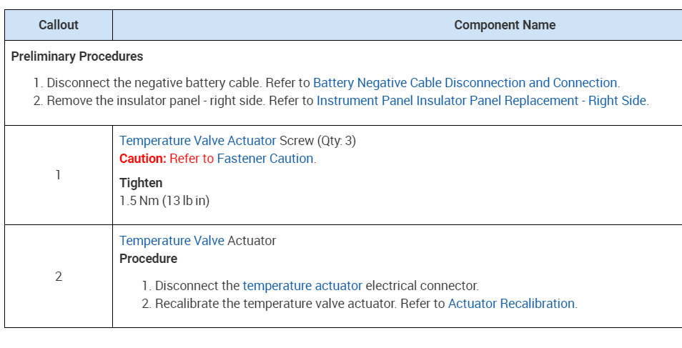

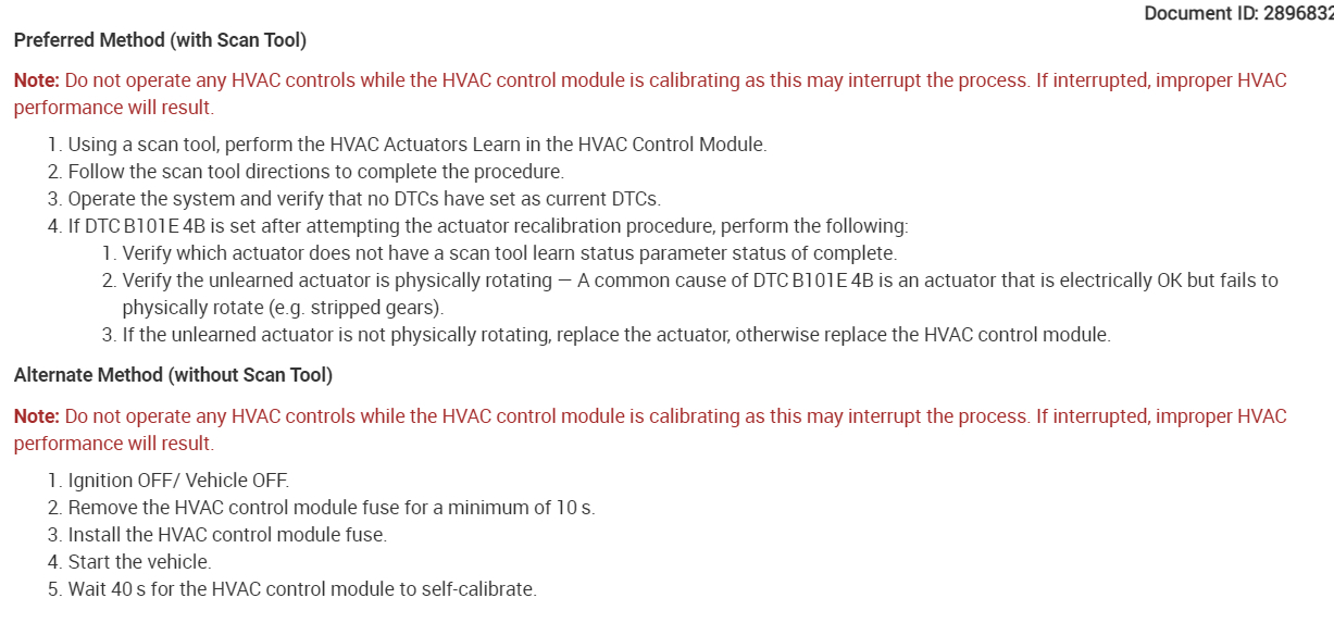

Is this a dual temperature zone HVAC system because it only shows one temperature blend door actuator? Check out the images (below). Let us know what happens and please upload pictures or videos of the problem so we can see what's going on.
