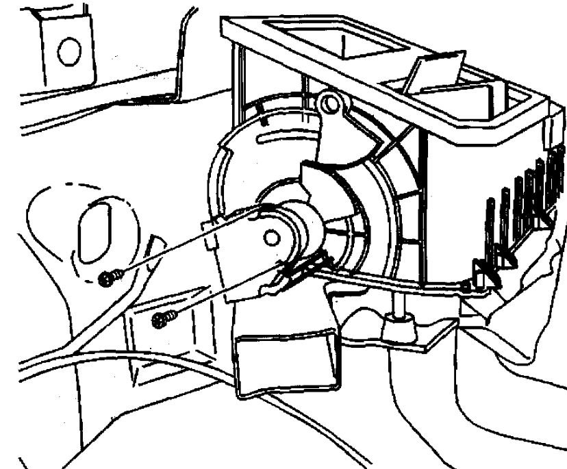

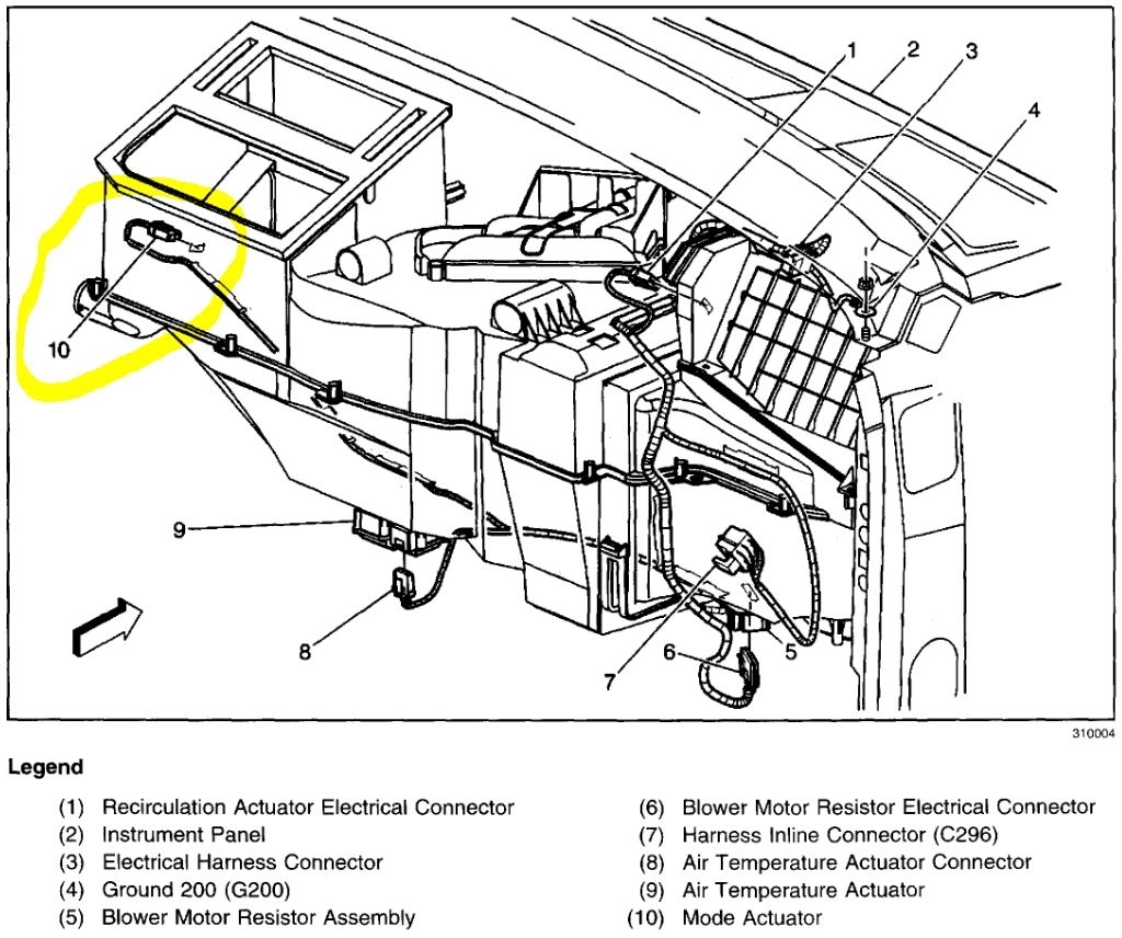

Truck has manual heat and air controls. Replaced the actuator under the glove box but no change. Is there another one under the dash on drivers side?
Nov 2, 2020 at 1:13 PM
STEVE W.
  • 15,200 POSTS

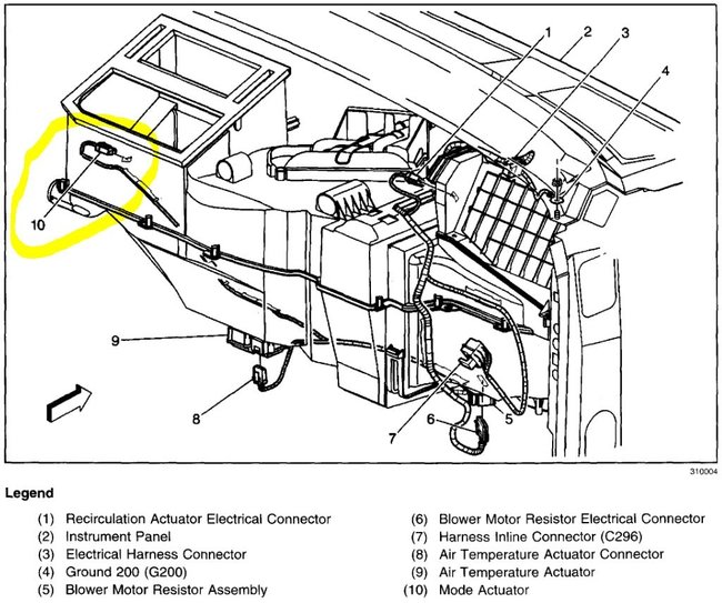

The mode actuator is on the top of the HVAC case on the drivers side of the housing up over the center console area. The one you changed is the blend door that controls temperature. The mode door uses an actuator and a plastic cam to move the various doors and flaps to direct the air and that plastic has a bad habit of breaking.
To get to it you need to remove the floor duct on the drivers side, then the console if equipped and the console duct. Then disconnect and remove the actuator and cam as a unit.
To install the replacement you reverse the process but need to be careful to
- Line up the heater/defroster valve lever with the mode actuator cam slot.
- Line up the A/C valve lever with the mode actuator cam.
Then test it before you put the other parts back on.

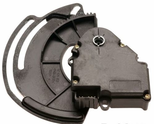

The part number for the replacement with the cam is - #52473356 and looks like the last image. You can get just the actuator but most times it's the plastic that breaks.

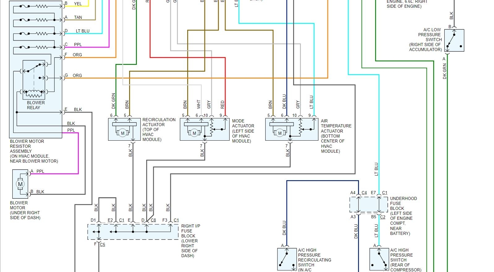

My Son just told me it could be the Defrost relay! I went to Lowes yesterday to get some materials and the truck would not turn over. I checked all the ignition fuses and then put the defrost relay into the slot for both the ignition and starter with no result. That makes me think perhaps it is the Defrost relay! I think I will put all new relays in today to see what happens.
Nov 4, 2020 at 10:52 AM
STEVE W.
  • 15,200 POSTS

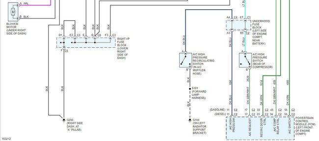

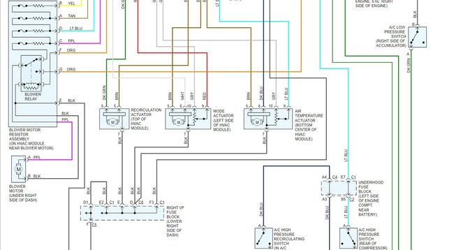

That relay sends power to the rear glass and mirrors if it has that defrost option. Nothing in the HVAC gets power from it. The attached is the wiring diagram for your HVAC system showing the actuators. The defog relay is turned on just for the high current draw of the wires in the grids. If your truck doesn't have that option then it's a spare relay.

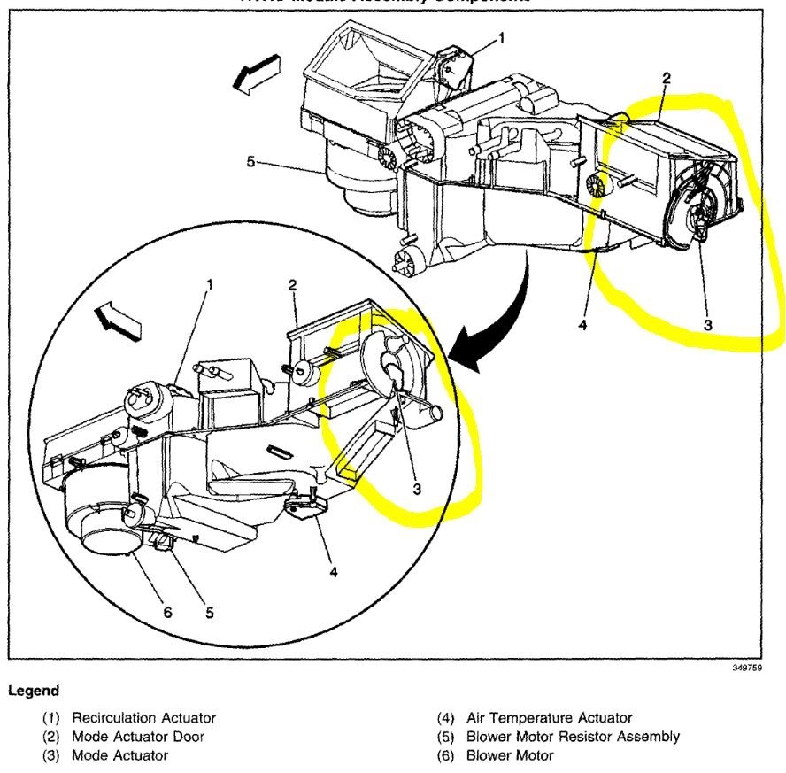

There are 3 actuators total, one behind the glove box and two on the opposite end of the case. If you changed out the upper one on the drivers side that has the large cam attached to it but the defrost still doesn't change over when you select it and you can see the mode actuator moving that cam and the door shaft, then it's possible the internal door itself has failed. For that the entire dash and HVAC case needs to be removed and the door repaired. I don't recall seeing one fail but it could happen, normally the issue is with the cam and actuator though.
