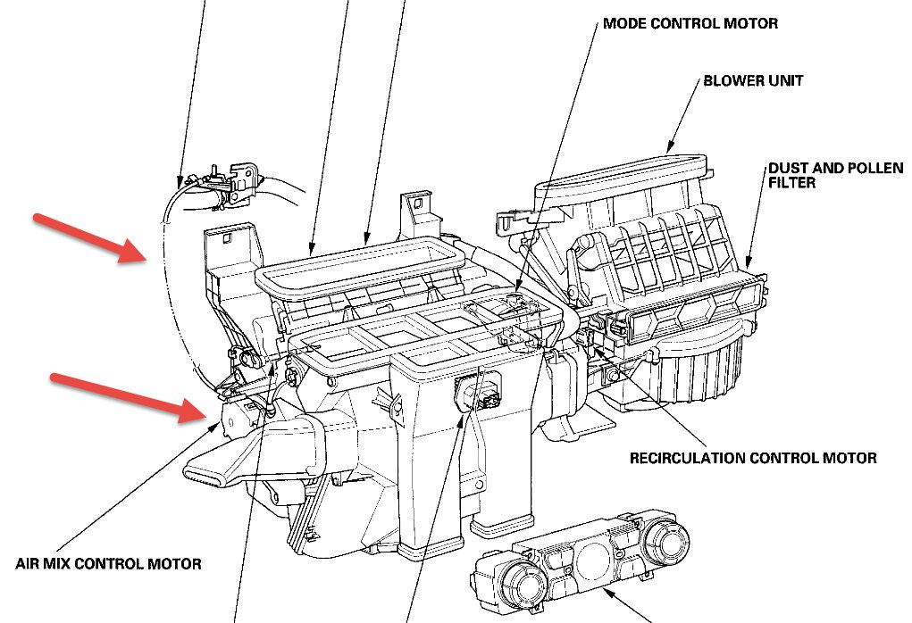

Actually blowing hot air on driver side semi cool air on passenger side.
How do you renew the temperature driver?

try pulling fuse 30 inside truck to see if it will reset. if not it may be an air mix motor problem also check cable for heat/temp for breakage. see pic I am assuming this is not auto temp control if it is just try pulling fuse then have a mechanic scan for codes.
