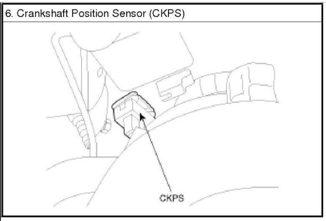

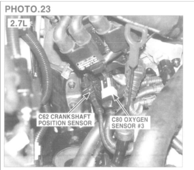

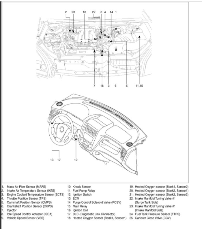

This sounds like a classic crankshaft angle sensor that has gone bad which will cause the engine to stall and no check engine light because the computer just sees the engine stop and does not know why (could be a mechanical problem etc.).
Here is a guide that will help you see what you are in for when changing the sensor and a diagram to help you see what it is like on your car:
Please let us know what happens so we can keep helping you.
