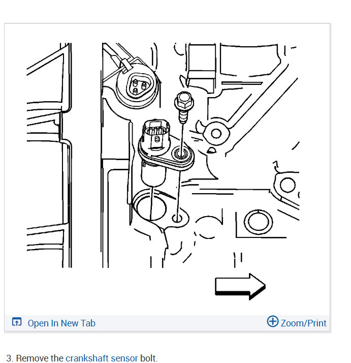

It started for about 4 seconds then shut off. It acts like it's trying to turn over but won't checked fuses look good, checked relays they look good, fuel is good. I went and checked for spark and had no spark at all.

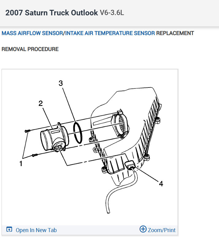

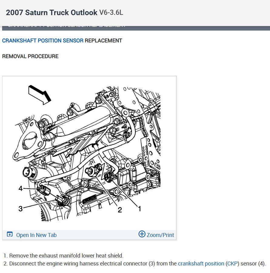

I have seen the MAF sensor go out can cause this issue, you can unplug it to see if the spark comes back, I have also seen the crankshaft sensor go out and do the same thing, no spark. Here is a guide on no spark problems to go over as well.
https://www.2carpros.com/articles/no-ignition-spark
Here is the location of the MAF and the crankshaft sensor so you can check it out:
You can use a scanner to check the RPM when cranking and if it is at 0, I would replace the sensor. Check out the images (below). Please let us know what happens.
