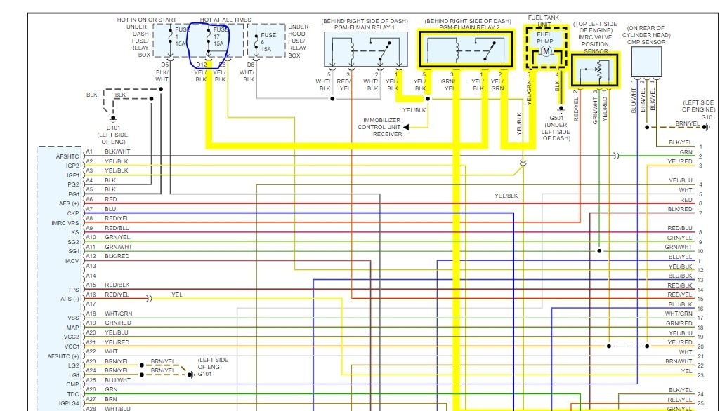

When you turn the key to the on position can you hear the fuel pump run?
I would start by testing the fuel pressure to be sure the pump is working correctly.

I attached a wiring diagram for you if the pump does not work. You would need a test light for some testing.

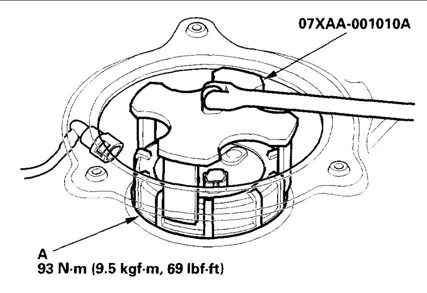

Fuel sender wrench 07XAA-001010A

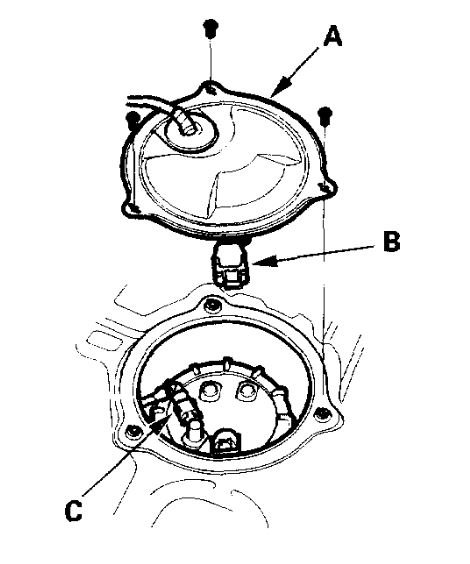

3. Fold the rear seats forward, and pull back the carpet to expose the access panel.
4. Remove the access panel (A) from the floor.
5. Disconnect the fuel pump 5P connector (B).

7. Using the special tool, loosen the fuel tank unit assembly locknut (A).
8. Remove the locknut (A) and the fuel tank unit.

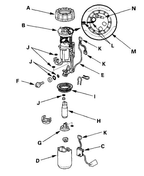

9. Remove the fuel filter (B), the fuel gauge sending unit (C), the case (D), the wire harness (E), and the fuel pressure regulator (F).
10. When connecting the fuel tank unit, make sure the connection is secure and the suction filter (G) is firmly connected to the fuel pump (H).
11. Install the fuel tank unit in the reverse order of removal with a new base gasket (I) and new O-rings (J). Be sure to check these items:
When connecting the wire harness, make sure the connection is secure and the connector (K) is firmly locked into place.
When installing the fuel gauge sending unit, make sure the connection is secure and the connector is firmly locked into place. Be careful not to bend or twist it excessively.
When installing the fuel tank unit, align the marks (L) on the fuel ta
