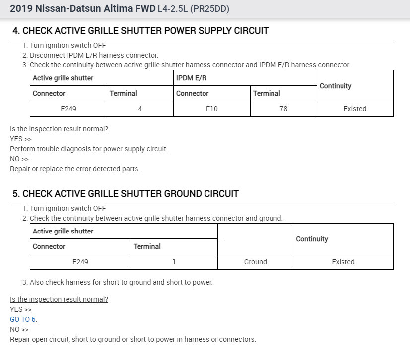

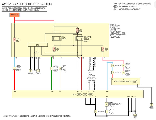

I recently had the MIL light come on my car listed above SL and received a P059F code when I pulled it with the OBD2 reader. After some initial research, I sprayed both sides of the shutter with WD40 hoping it may allow it to move. I also confirmed there is no debris cause in the shutter.
I am thinking a blown fuse may be an issue, but I am struggling to identify which fuse may be the issue as I can't find a decent diagram.
Any guidance on finding the correct fuse or other tips to solve this issue would be greatly appreciated!
May 31, 2022 at 2:42 AM
SQM
  • 6,383 POSTS

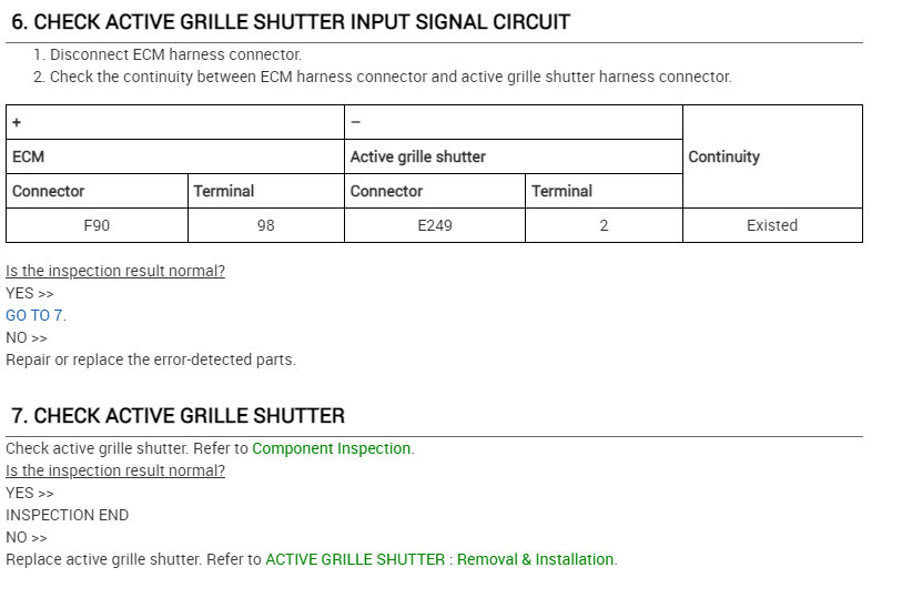

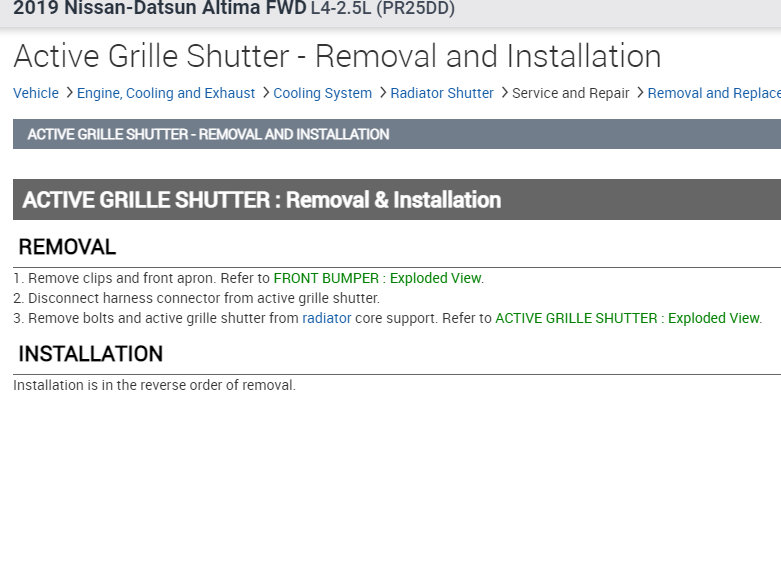

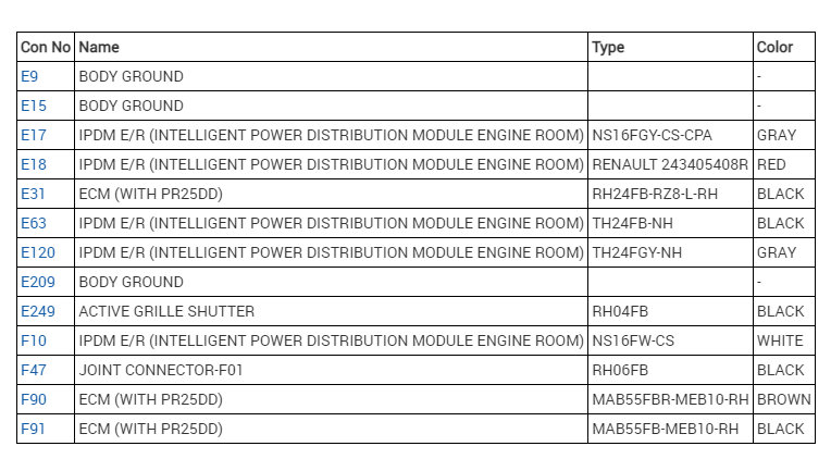

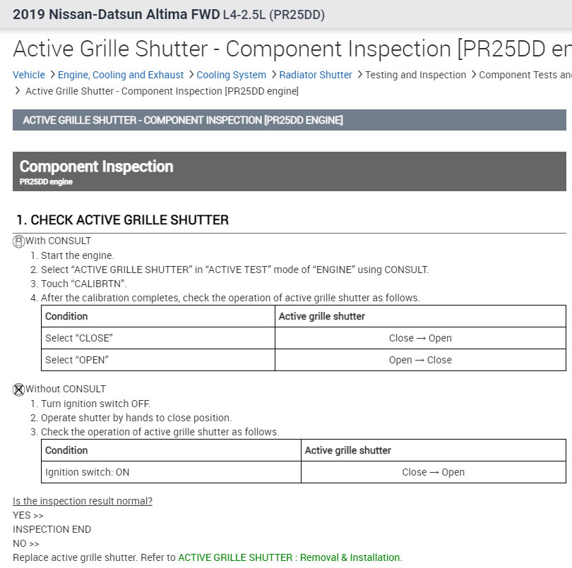

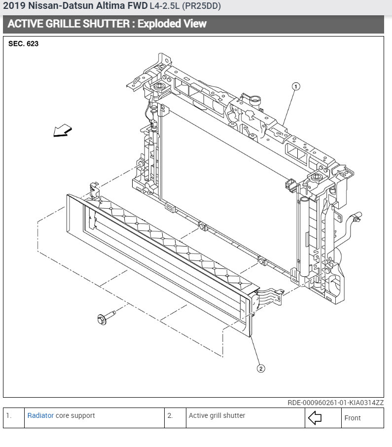

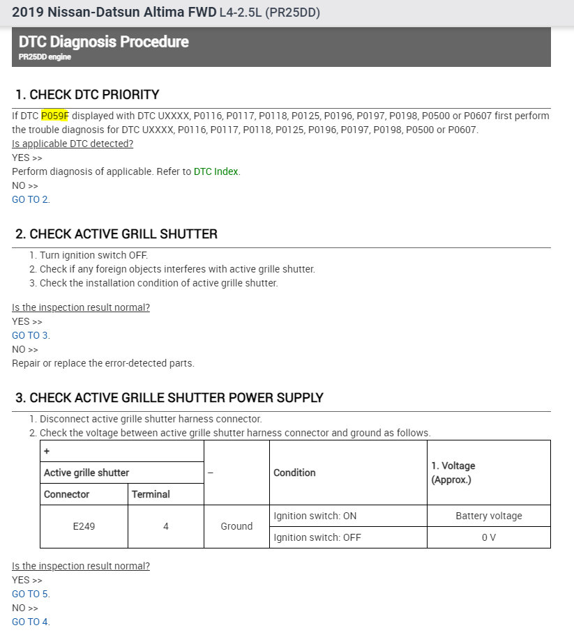

This could be due to a wiring issue or having a faulty grill shutter.
I have attached the trouble shooting guide as well as the wiring schematics below for your reference.
Follow the guide as it can help you determine the issue.
Let me know of any questions.
