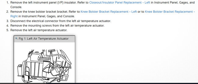

Drivers side blows cold air with heat on. Passenger side blows hot. If I replace actuator do I replace the drivers side one and is there any videos on how to do it?

try pulling HVAC fuse inside car it may reset the actuator if not then check actuator for power we do not have any videos that I see just a link for blend door which is not what yours is.it is on drivers side so see picture for instructions.
