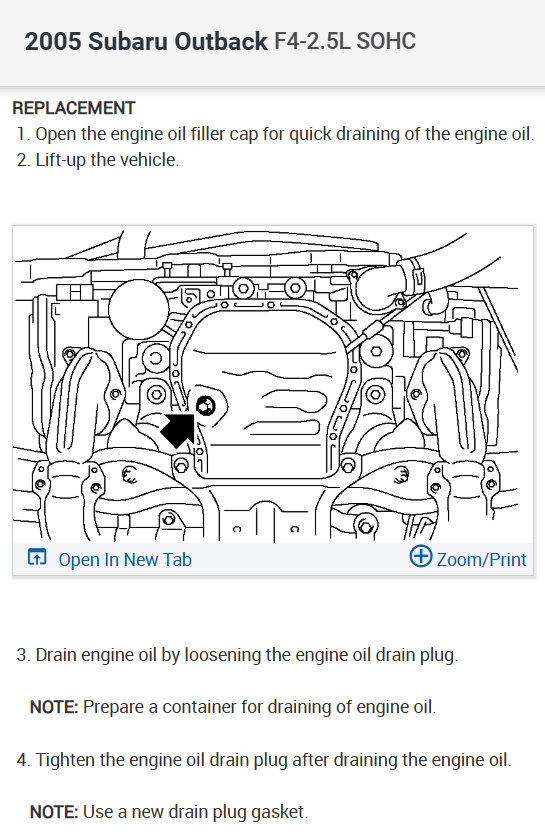

we had a leak and was just trying to stay up on it just had full oil change and new filter a few days ago. Will this ruin my car I've only driven it about 15 minutes so far and just did it about an hour ago.
Feb 2, 2025 at 5:27 PM
  • 55,432 POSTS

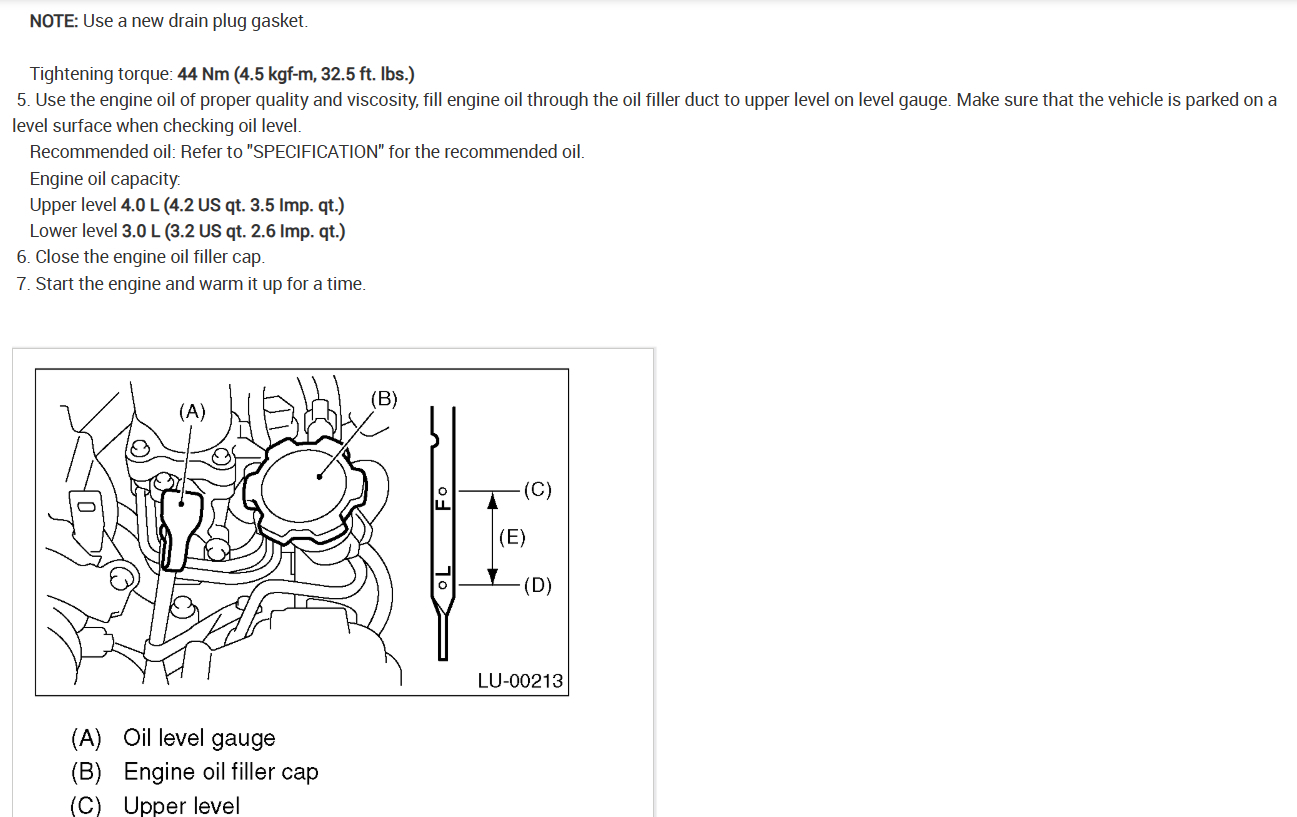

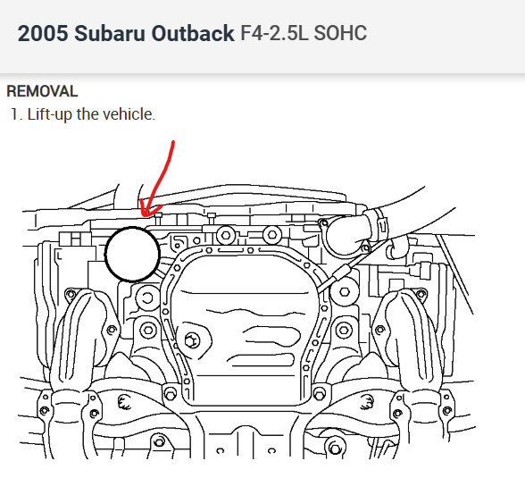

I would change the oil and filter ASAP. If the engine sounds okay, then no damage was done. Here is a guide to help walk you through the step with instructions for your car in the images below:
https://www.2carpros.com/articles/how-to-change-engine-oil-and-filter

Oil capacity .................... 4.0 L (4.2 US qt, 3.5 Imp qt)
