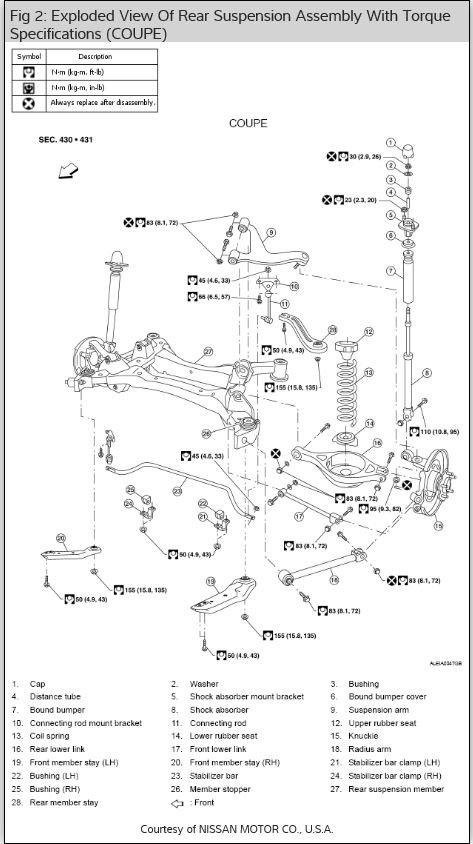

We were in an accident yesterday and were hit in the back left side, it bent the left tire in. Can you tell me what might have to be fixed on it?

Well of course you know the wheel and the tire if it blew out.
It is best to take it to a shop that has a wheel alignment machine cause if any of the parts back there are not obvious to the eye that they are bent, checking the rear wheel alignment on their machine will help see and tell what parts are bent just slightly throwing the alignment off.
Here is an idea of the parts that the shop will check.
