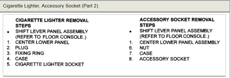

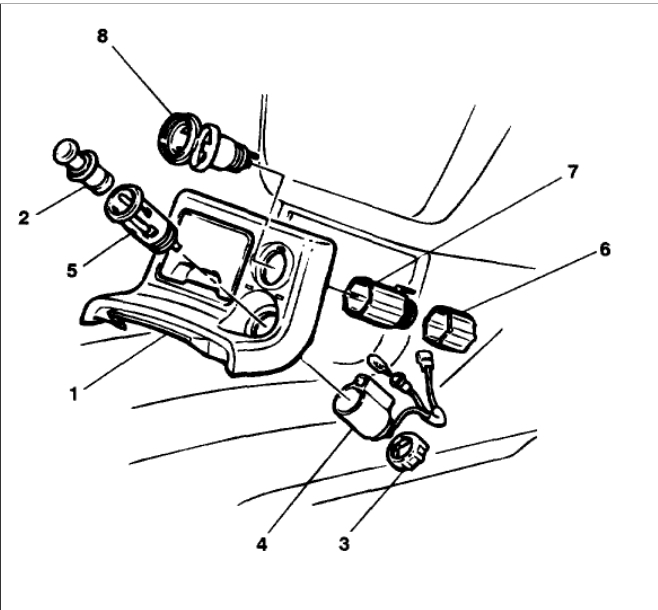

Accessory socket not working. Need instructions on how to remove original sockets.
Jun 10, 2018 at 2:02 AM
Experienced Mechanic
55,770 POSTS
Is the accessory port just not work or did it fall apart? Here is how you replace the port (below). Does the port have power?
