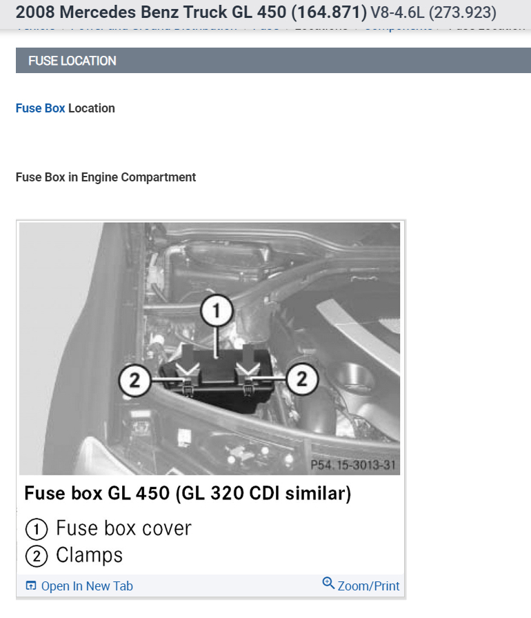

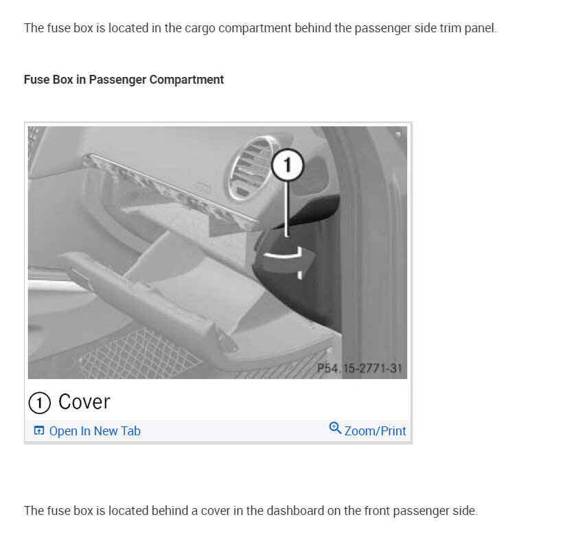

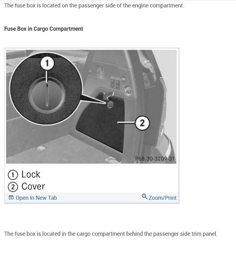

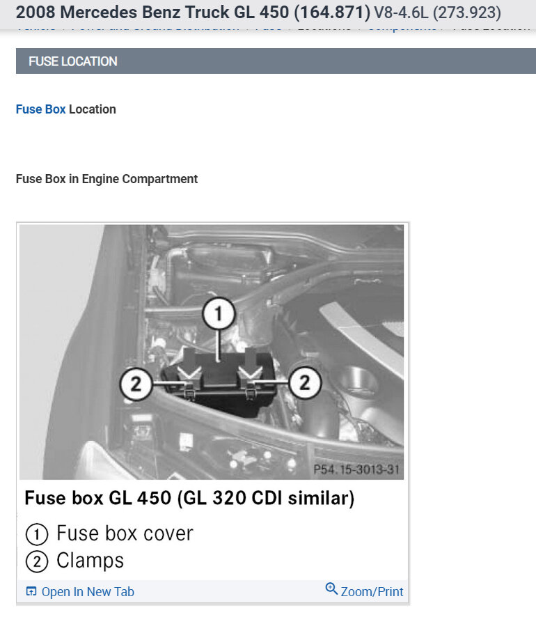

Next, I would check all fuses in the car with the systems on, this guide can help:
If all the fuses are okay, it could be the driver's door module or the rear SAM control unit. We will need to do a CAN scan to see what codes come up, you can get a CAN scanner (Controller Area Network) which will work on most cars from Amazon.
