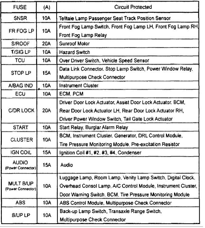

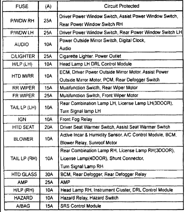

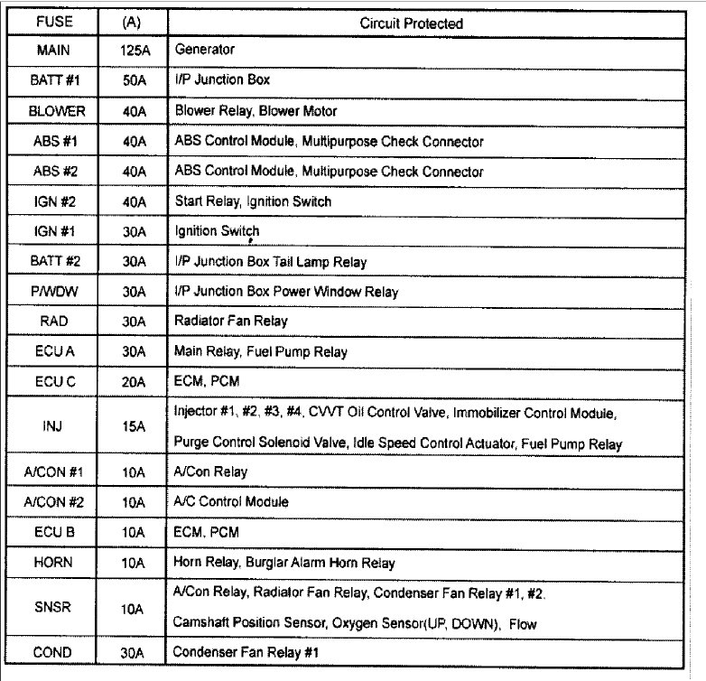

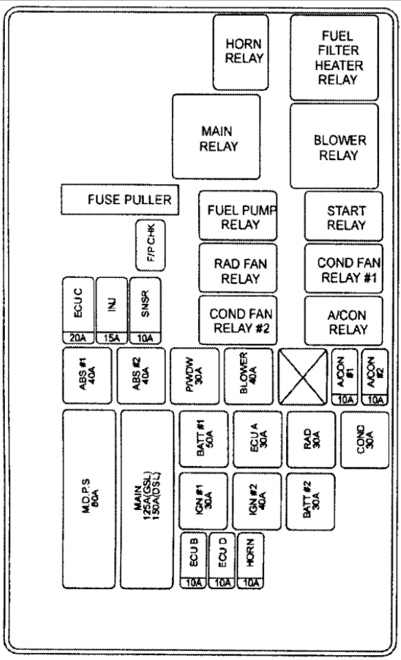

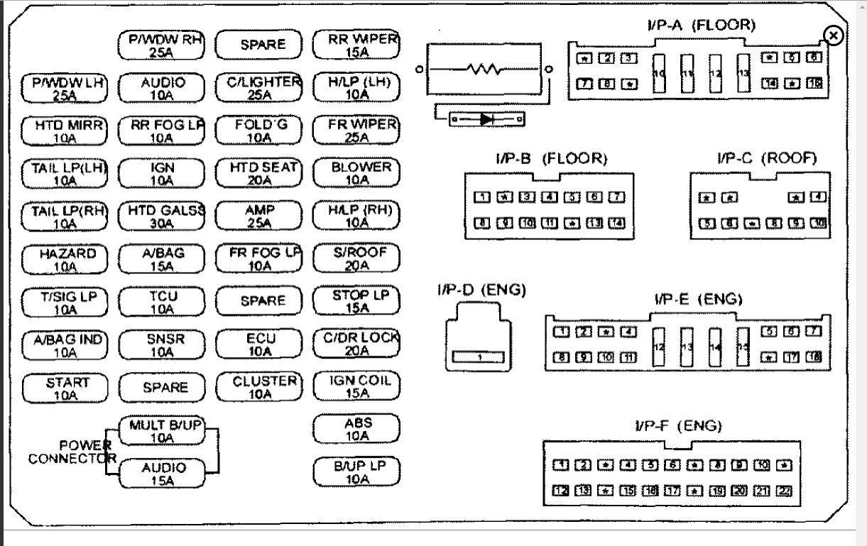

Those are communication codes so one of the computers is not talking for some reason. I would start by checking all system fuses. If one of the computers is not getting power it will cause this error.
Here is a guide and some diagrams of the fuse box (below) so you can do some testing.
Please check all system fuses with the key "on"
Please run this test and get back to us.
