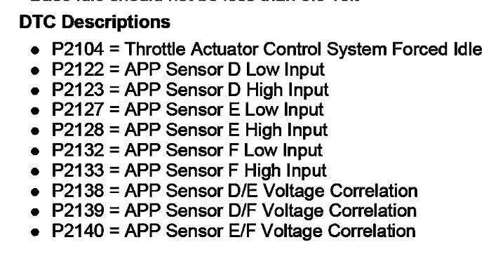

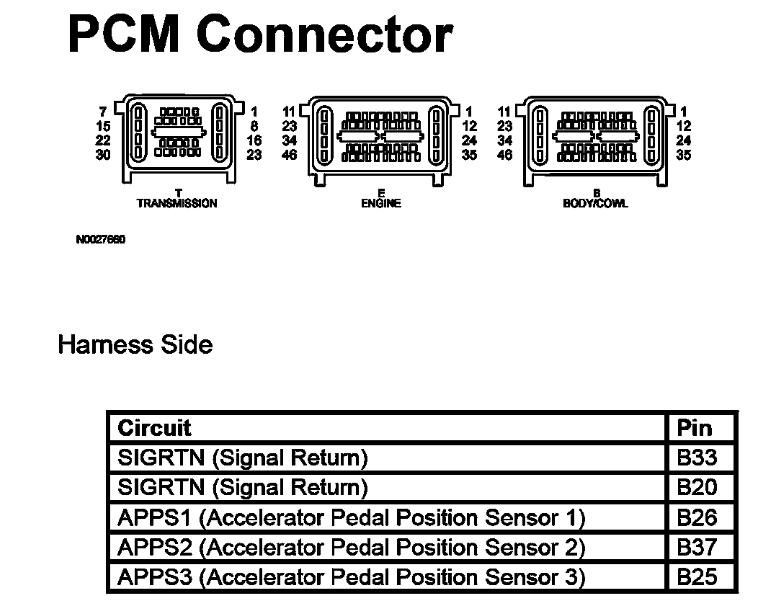

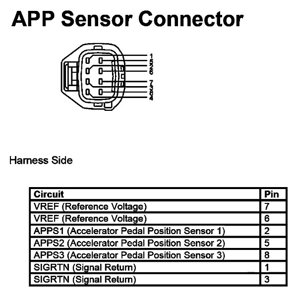

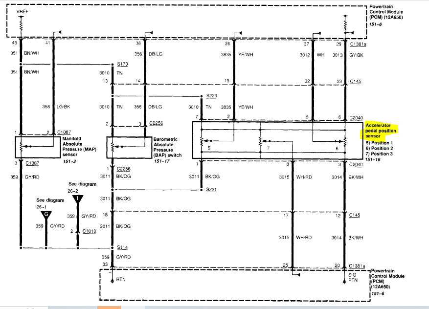

It's a 6.0l diesel and the pedal wiring got messed up, so I need the pin out for it.
Apr 1, 2023 at 2:39 AM
Experienced Mechanic
110,244 POSTS

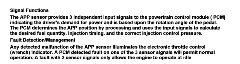

That isn't a good thing. LOL Regardless, I attached the connector pinout for both the APP and the PCM. The last pic is the wiring schematic.
Let me know if this is what you needed or if you have other questions.
