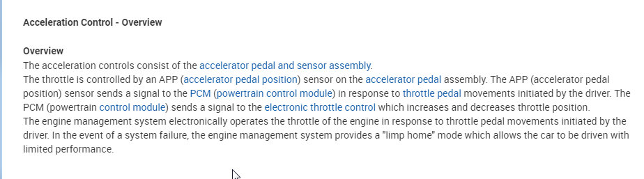

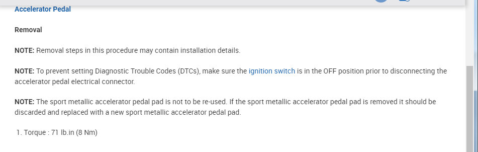

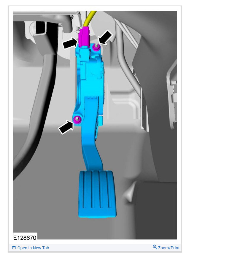

This is odd. The accelerator pedal is just a lever that as a sensor in it. The sensors measure how far the pedal is pressed and then sends a signal to the PCM where it controls the throttle blade.
I don't see it as an option but do you have adjustable pedals? If it has moved then I have to imagine the assembly is broken. Can you get a picture of it if this doesn't make sense? I would look up to where it bolts to the floor board and see if it has come loose.
