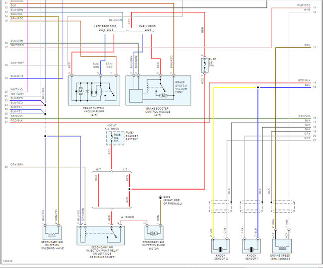

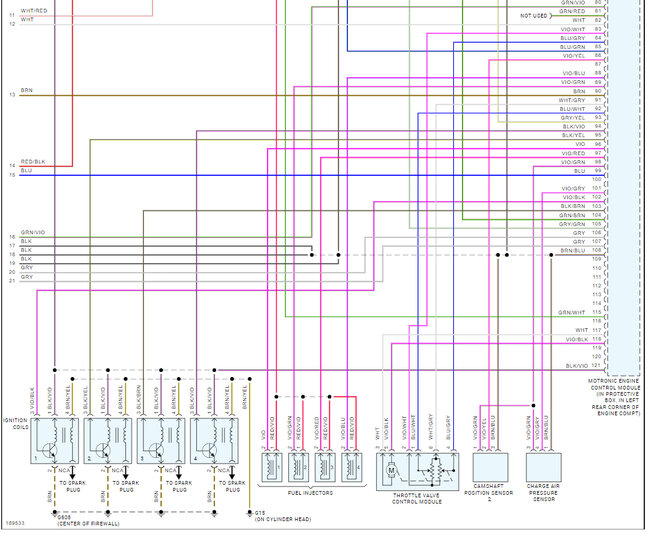

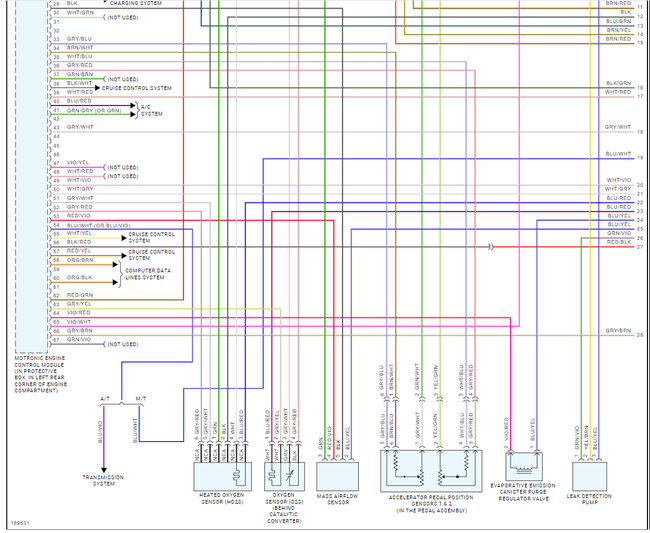

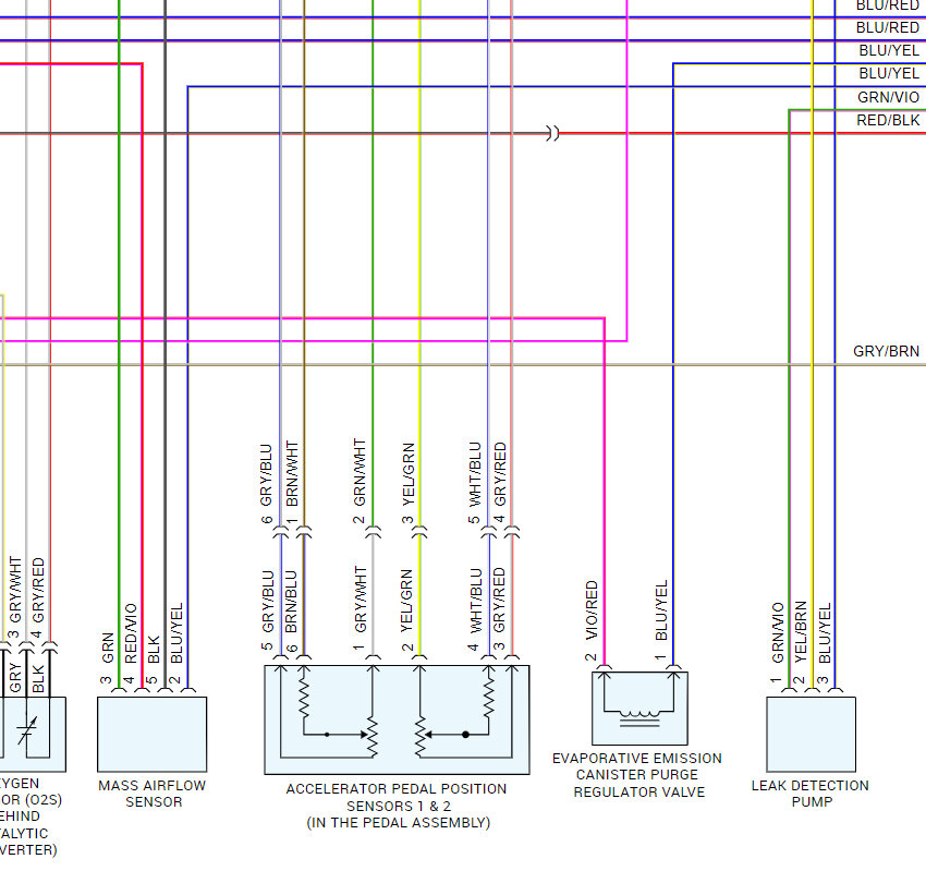

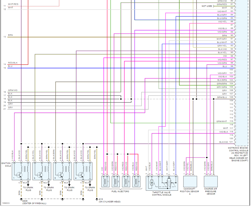

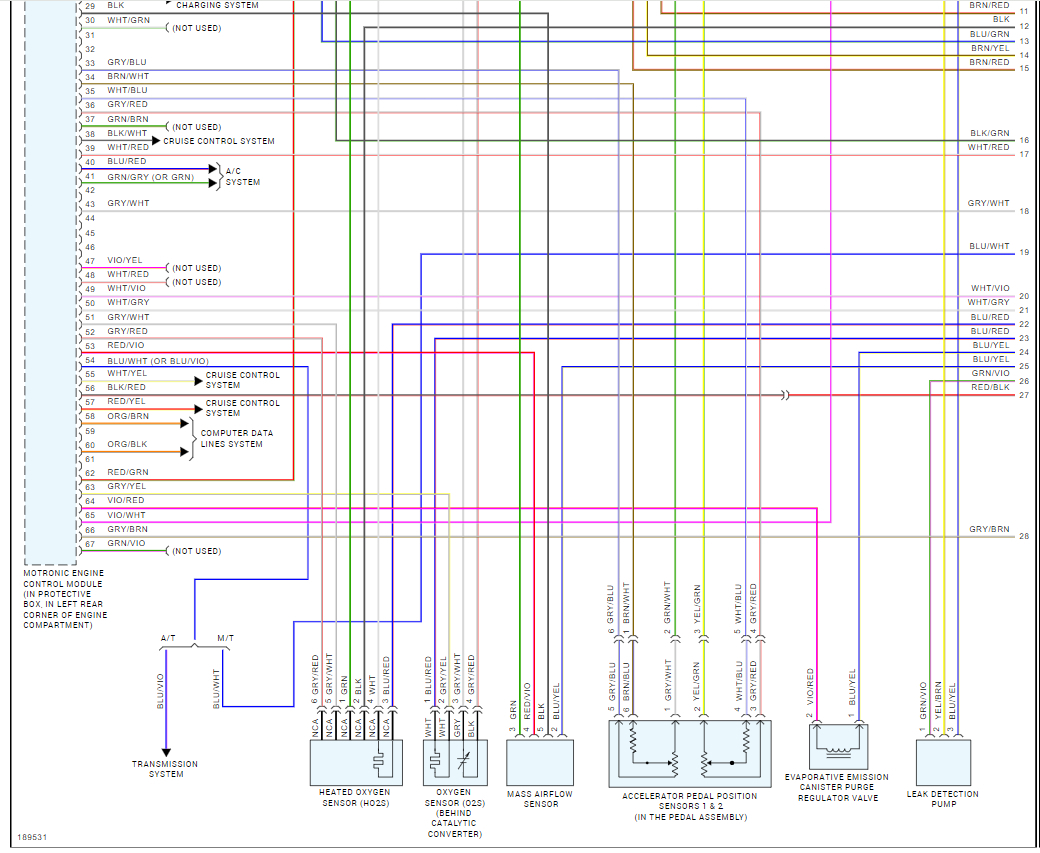

Greetings. Does anyone have the wire diagram of the electronic accelerator pedal? Thank you.
Aug 15, 2024 at 4:45 AM
  • 55,433 POSTS
Sure, here is the wiring diagrams for the accelerator wiring diagrams and a guide to help do the testing:
Check out the images (below). Let us know if you need anything else.
Aug 17, 2024 at 1:47 AM
ECLECTIC ECLECTIC
  • 21 POSTS
If you have the wire values of each wire. Thank you.
Aug 24, 2024 at 6:14 AM
  • 55,433 POSTS

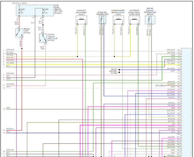

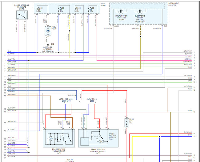

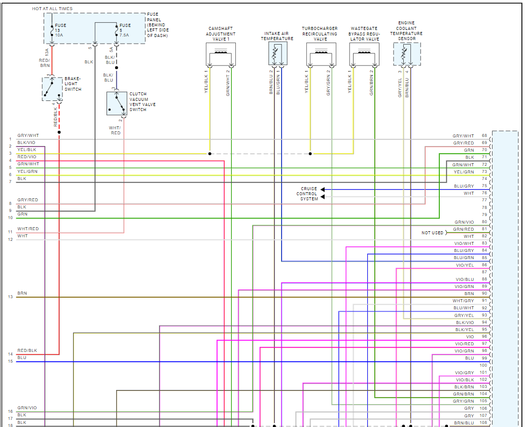

They don't give us those sorry, here is the complete wiring diagrams though which can help. Here is a guide that will help you test the wiring and the complete engine wiring diagrams below.
