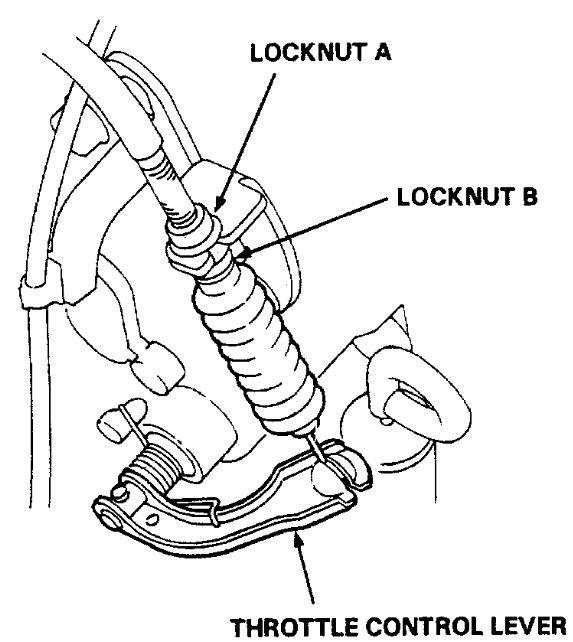

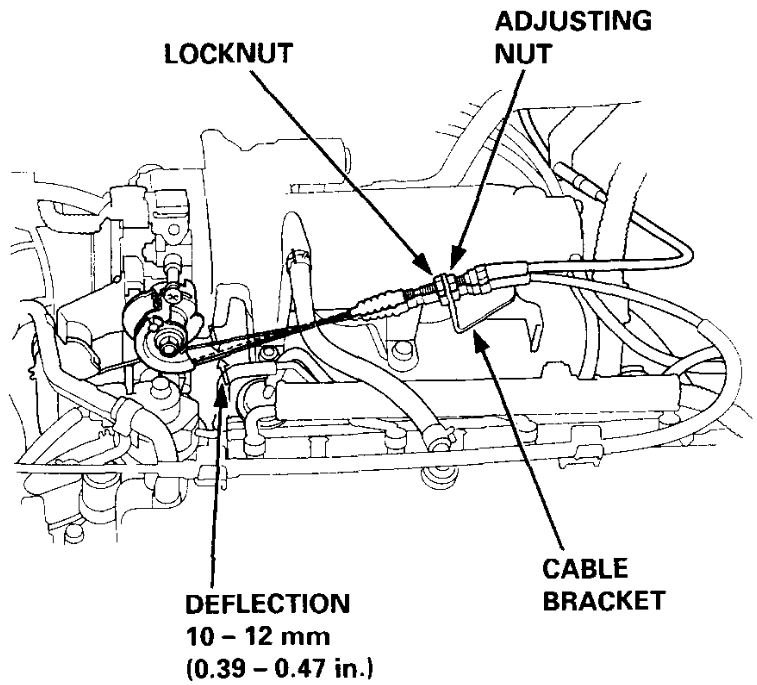

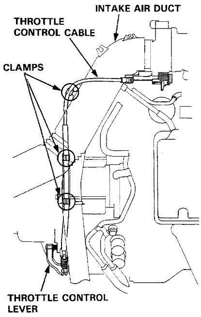

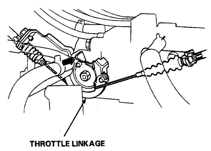

I am putting my accelerator cables back and I need a diagram to make sure I'm putting them back correctly. can anyone help please?
Sep 10, 2019 at 5:16 PM
MASTERWRENCH
  • 258 POSTS
Hello Chris,
Please see the attached diagrams for throttle cable routing. I've attached one for the 2.2L and several for 2.7L.
Let me know if you need anything else!

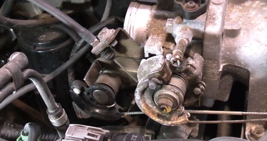

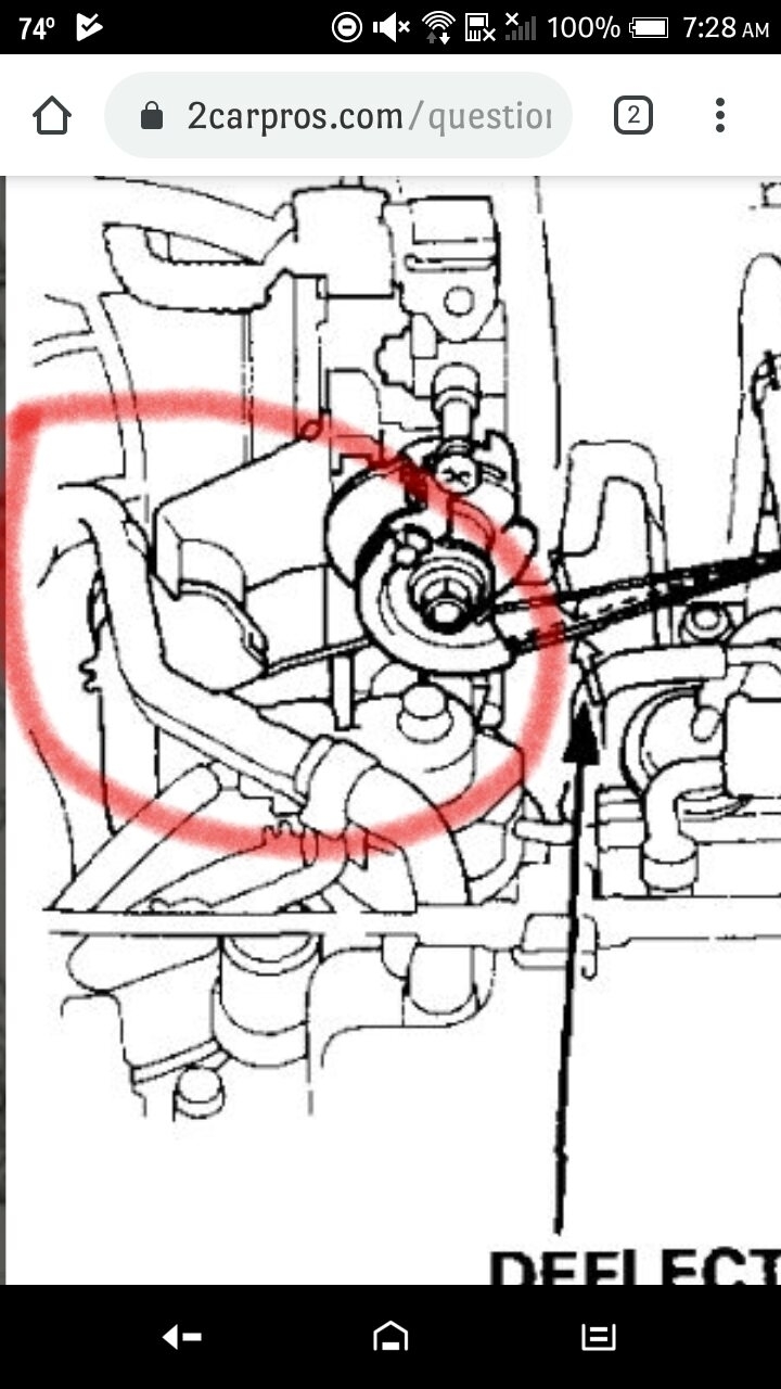

I'm trying to figure out how to get this cable back on track, if that makes sense.
Sep 10, 2019 at 10:34 PM
MASTERWRENCH
  • 258 POSTS
Chris,
This picture may be a little more helpful. Sometimes the line-art pictures from the service manuals aren't the best.
Sep 10, 2019 at 11:55 PM
CHRISTOPHER IVAN ROEDER
  • 156 POSTS
That's perfect, thank you. mine must have had a plastic piece break off somewhere cause the cable doesn't go in like it's supposed to. thank you very much.
