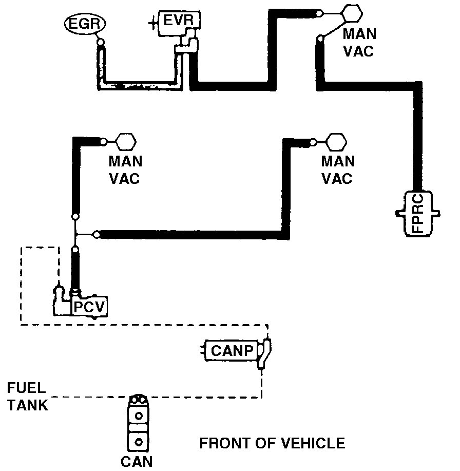

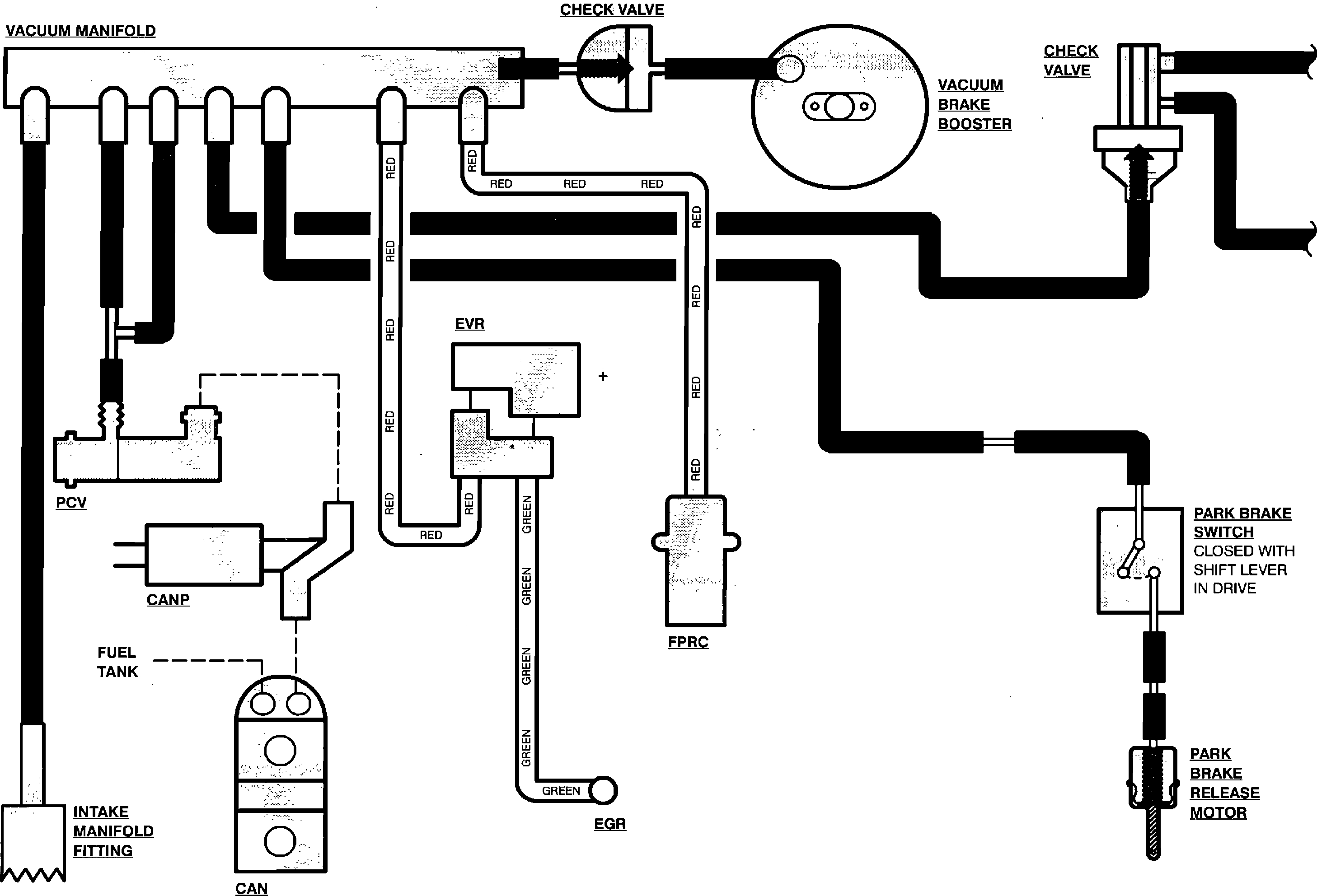

It has had this back fire, engine running poorly upon acceleration for quite a while, but this jerking thing the car does at highway speeds began after I fixed a vacuum leak that runs from a T connector on the passenger side to another port on the drivers side of the engine. It passes between the block and the intake. Next to the one connected to the fuel rail. What the heck is going on with this car?

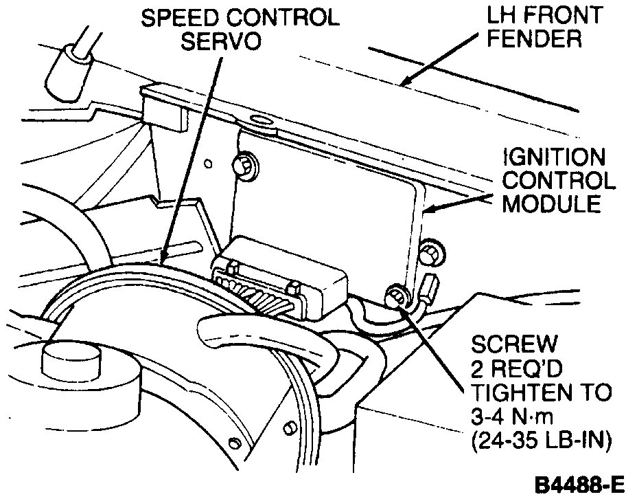

Check the ignition module plug, these have a TSB about moisture getting into the connection and causing rough idle and running poorly. Make sure the pins are clean, dry and fit properly. If in doubt some contact cleaner and plugging it in out a few times then apply some dielectric grease around the boot to give a better seal.
Another thing to check, you say it starting acting a bit different after you fixed the leak, check the hose at the fuel pressure regulator, it should be dry inside, if the regulator diaphragm is bad it can draw in fuel there and cause running issues. Not real common but it happens. Another test would be to disconnect each vacuum line and see if anything changes. The EVAP and EGR can both cause issues.
