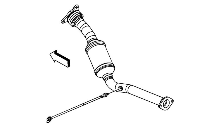

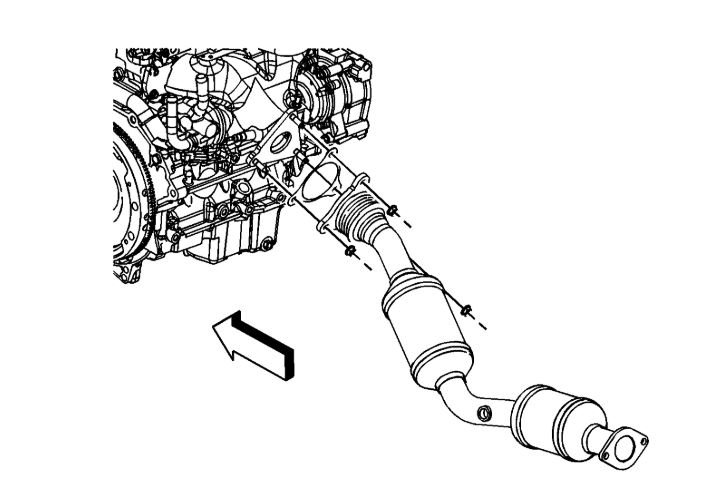

It sounds like the catalytic converter is clogged not allowing the engine to breathe.
It will give you low power. You need to do a back pressure test. You could remove the front O2 sensor and drive the car and see if it runs better. That will confirm the converter.

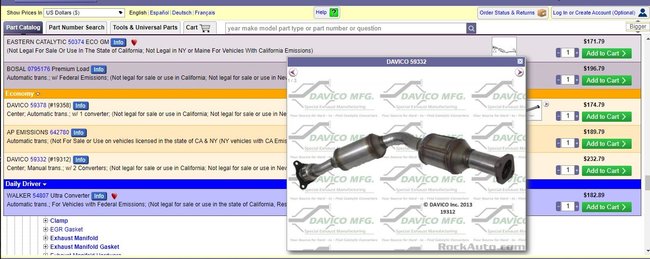

okay and is it cheap to fix a clogged converter?
Mar 2, 2020 at 4:52 AM
It needs to be replaced, not cleaned. You cannot clean a catalytic converter.
