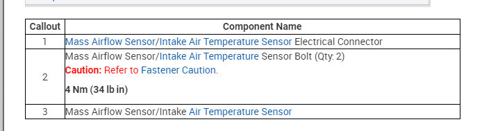

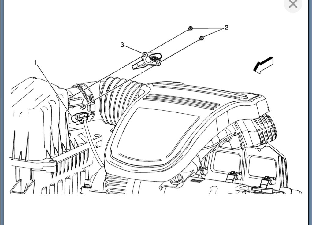

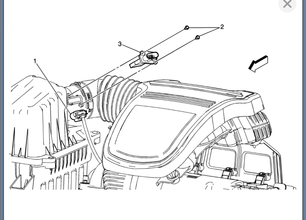

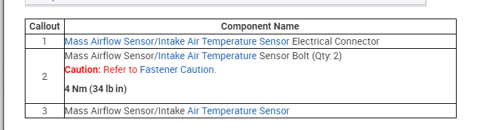

We need to check the MAF and see if it is dirty as well. If this is telling the engine the wrong info, then it will cause these types of issues. Here is a guide that will help with cleaning it and the throttle body:
https://www.2carpros.com/articles/mass-air-flow-service
Below is the info on the MAF as well.
Let's start with this info and go from there.
