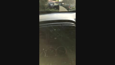

There is a pretty solid clank coming from the center/front end of the car. After accelerating and braking. Lifted the car and replaced the lower motor mount. Cannot seem to find anything loose.

GONZO278

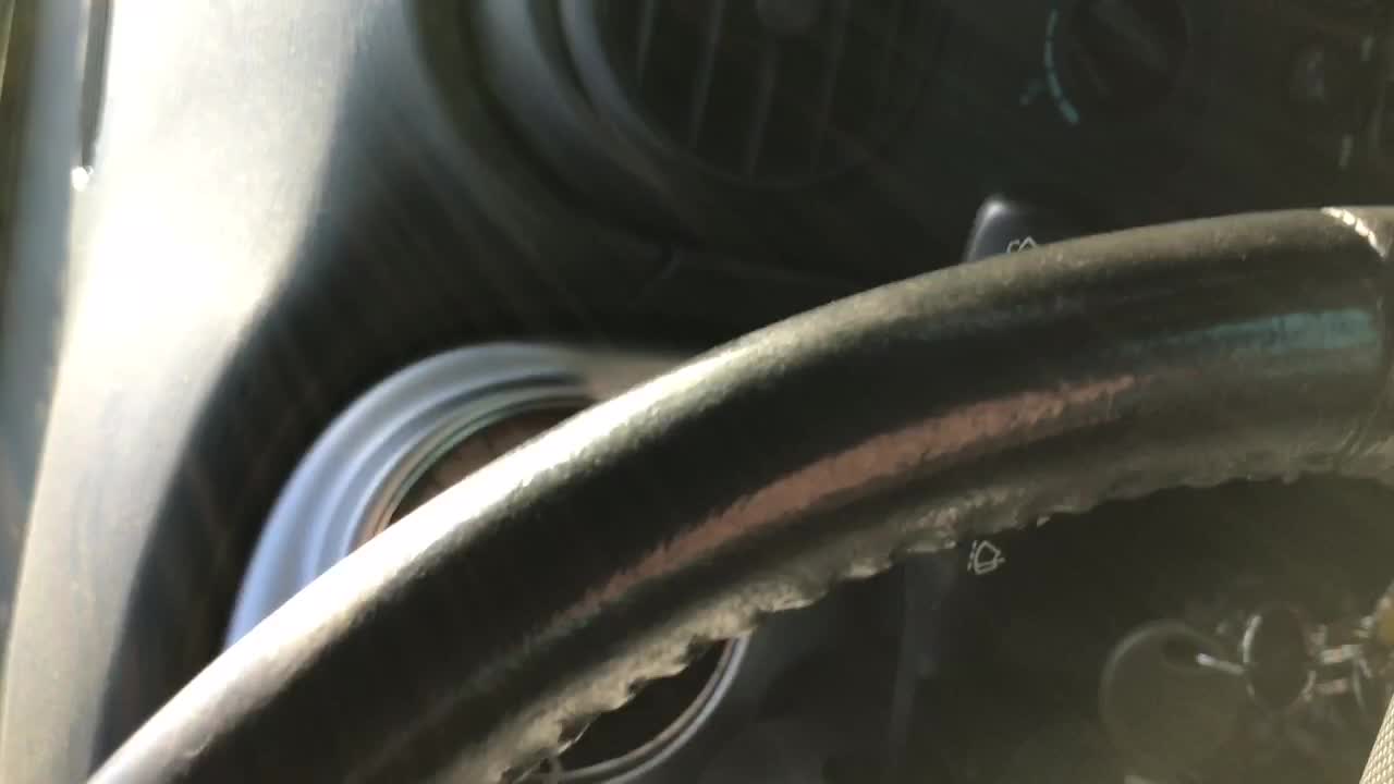

I am not sure if you can hear the video. Thank you for your help! I appreciate it!
Apr 1, 2018 at 7:07 PM
Yes, sounds like a motor mount. it sounds like the engine is jumping up and down.
I suggest you take it to a shop and let them listen to it. that will confirm. they can also tell you which mount. let me know what they say and if you want to replace it yourself, I can source it and give you the procedure.
