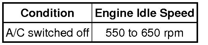

(d)Start the engine and check that the MIL is not illuminated and that the idle speed is within the specified range when the A/C is switched off after the engine is warmed up.
Standard (for Automatic Transaxle):
see pic 1

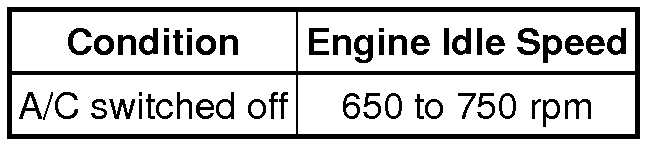

Standard (for Manual Transaxle):
see pic 2
