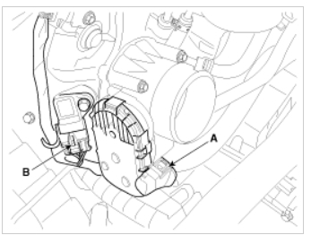

I have acceleration issues mostly going uphill for about two weeks now. I had my spark plugs replaced about a week ago. The other day i was on the highway and it was stalling. I exited off at a stoplight and it idled loud then went back down. I drove to the next stoplight and the car cut off and all the lights came on in the dashboard. I crank it back up and went home. Had the alternator tested and it was bad. I had it replaced a few days ago but still runs the same

I would service the throttle body first, also are there any codes stored? Here is a video to help you get the codes and a guide to help you service the throttle body with a image below as well.

Yes I got a code p0106 which pointed to the MAP sensor. I had that replaced today and the rough idling stopped. The car no longer cuts off but it is still slowly accelerating on highways especially on incline.
