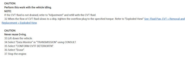

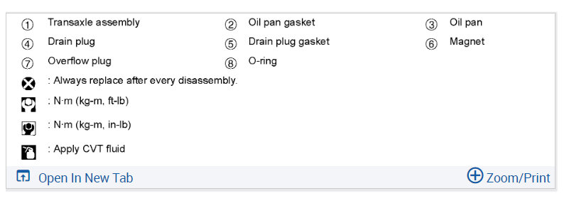

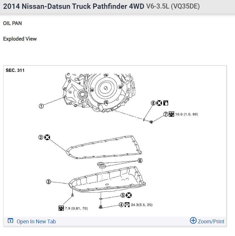

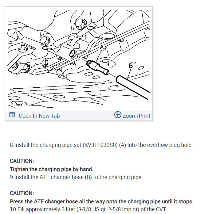

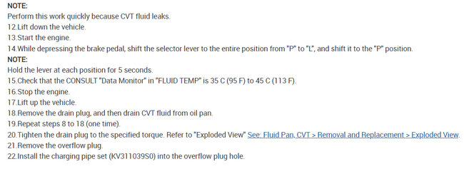

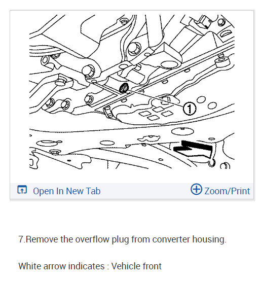

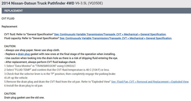

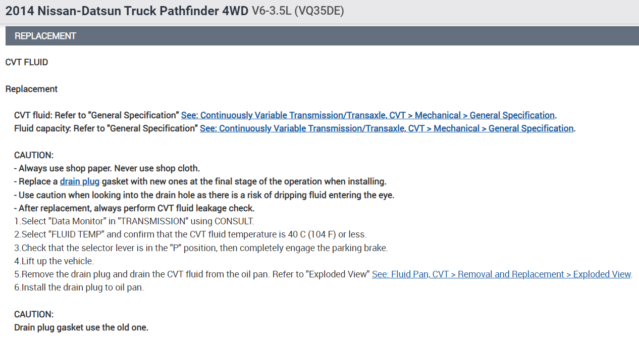

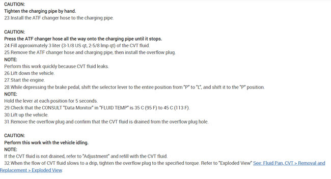

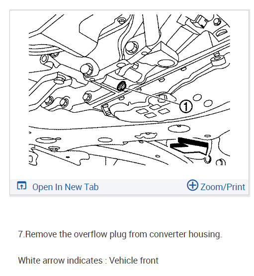

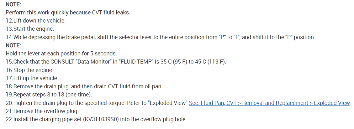

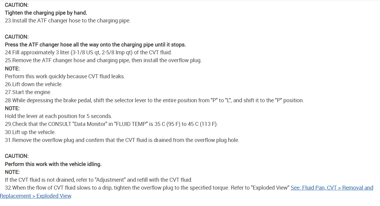

The P17F0 code on a 2014 Nissan Pathfinder is typically related to a transmission issue, which can cause the vehicle to go into limp mode.
So, I can tell you these transmissions had big problems with the belt burning up, can you please remove the transmission oil pan to inspect for metal in the pan and also, we can check the fluid condition as well. This can help us determine if the transmission is bad. Here is the fluid type and how to do the job.
Fluid Types
Transmission Fluid
Type .................... Genuine Nissan CVT fluid NS-3*
*: Use only Genuine NISSAN CVT Fluid NS-3. Using transmission fluid other than Genuine NISSAN CVT Fluid NS-3 will damage the CVT, which is not covered by the NISSAN new vehicle limited warranty.
Capacities
CVT Fluid
Capacity .................... 9-1/4 qt (8.8L)
Check out the images (below). Let us know how it goes.
