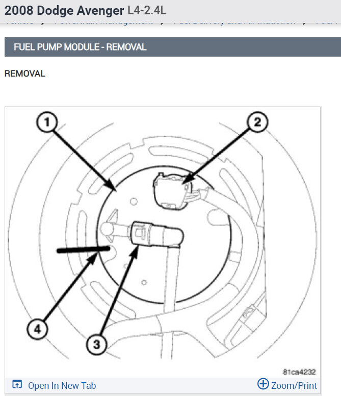

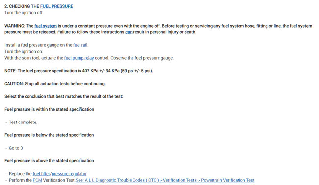

Why when I accelerate at slow speeds it feels like built up air and the car will jolt and jump RPMs?
162,000 MILES • 2.4L • 4 CYL • 2WD • AUTOMATIC
JAYJOHNSON0318
  • 40 POSTS
Also, when going uphill trying to accelerate it'll do one jerk at a time and if I let off the pedal it'll stop. Just recently replaced throttle body car is not reading off any codes. idk what it could be. What do you think?

It could be a few things. For example, it could be a fuel pressure-related issue, a large vacuum leak, or even a partially plugged catalytic converter.
When this happens, do you ever notice any odd smells or sounds? Does the engine overheat?
Also, have you checked to make sure the fuel pressure is within the manufacturer's specifications?
Jan 8, 2024 at 10:43 AM
  • 55,746 POSTS

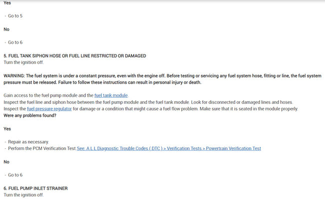

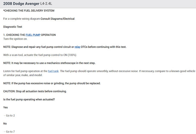

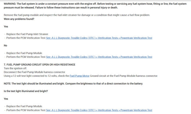

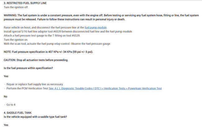

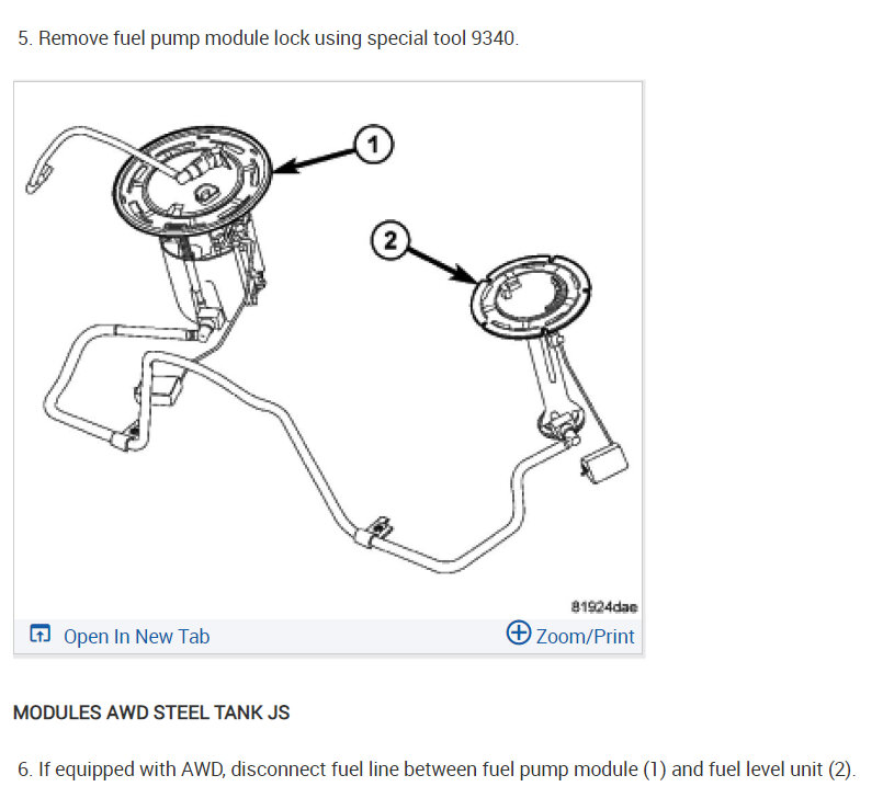

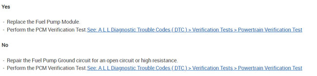

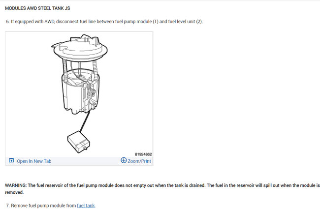

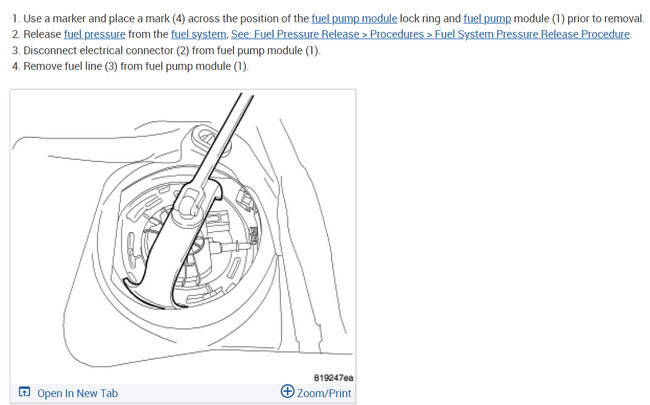

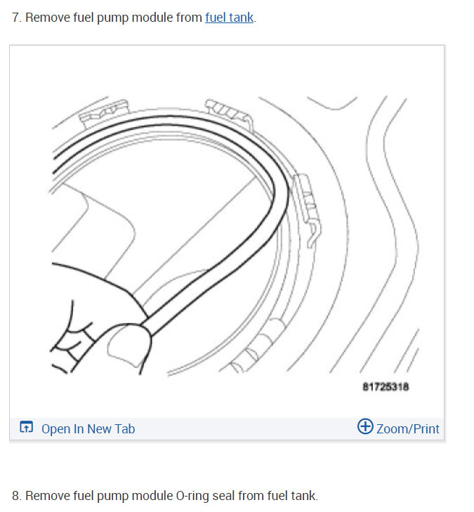

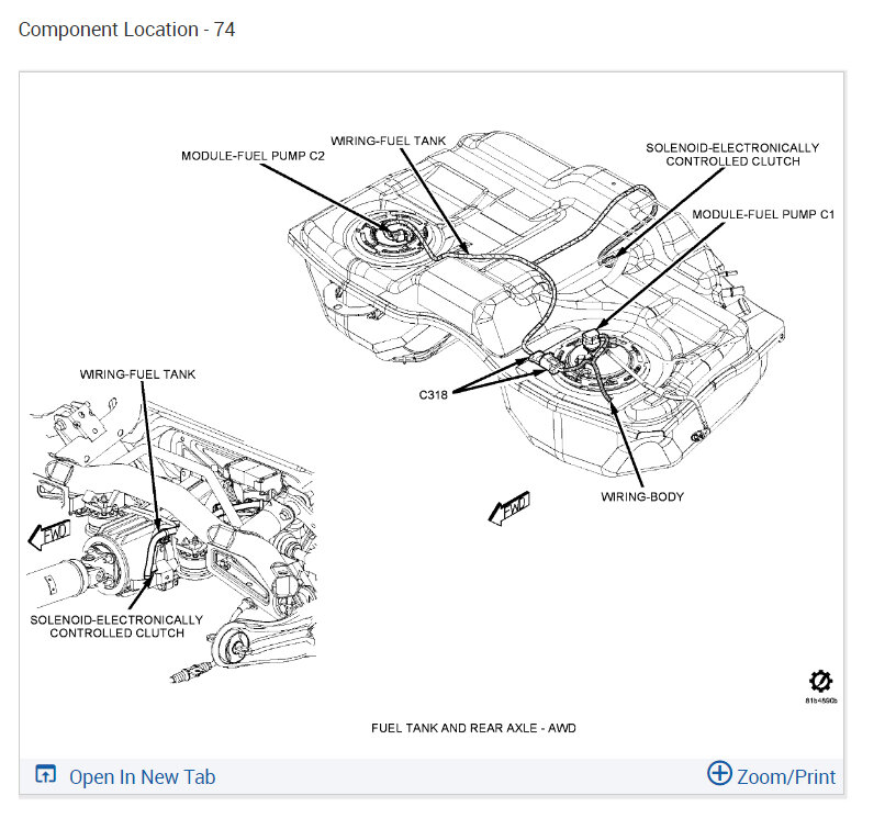

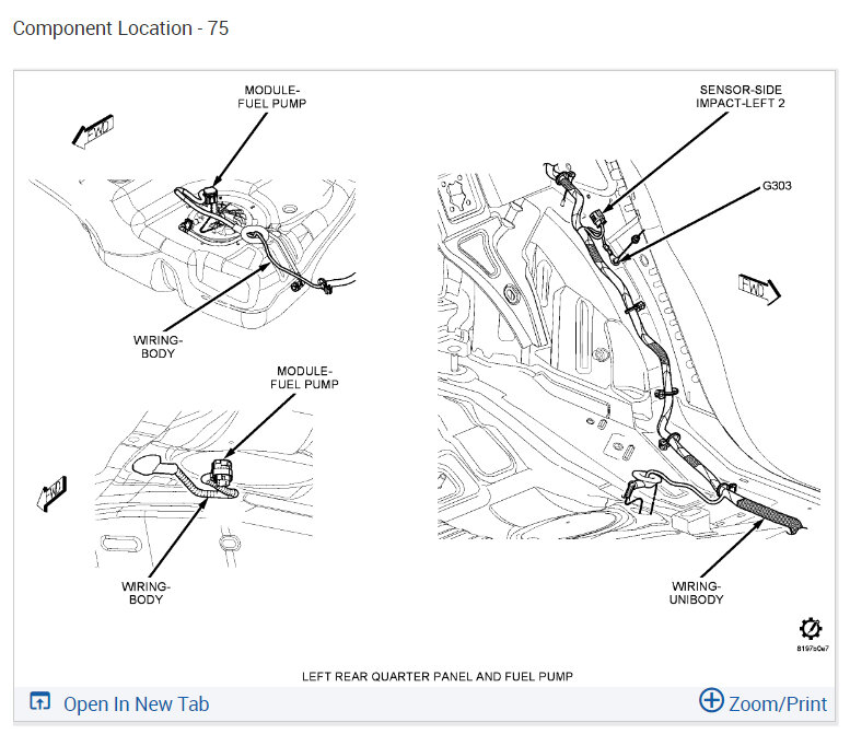

This can be a fuel delivery problem which means a weak fuel pump or a MAF sensor that has gone bad but is not showing any codes which is possible. First, I would check the fuel pressure,
Here is a guide to help with instructions below to show you how on your car:
FUEL SYSTEM PRESSURE
400 kpa ±34 kpa (58 psi ± 5 psi)
Fortunately, the fuel pump can be accessed under the rear seat. I have also seen the TIPM start to go out and cause pretty strange problems as well, but we can tackle that as needed. You can rent a fuel pressure gauge at the auto parts store for cheap or free. Check out the images (below). Please upload pictures or videos of the problem so we can see what's going on.

I notice a rotten egg smell when trying to accelerate at higher speeds. it'll rev really high for me to even go faster speeds. No overheating.
Jan 8, 2024 at 12:10 PM
  • 55,746 POSTS
This can be a clogged catalytic converter, which lowers the vacuum reading and makes the computer think you are going up a hill and dumps more fuel into the system, which makes the situation worse.
Here is a guide to help us confirm the problem:
Please go over this guide and get back to us.
