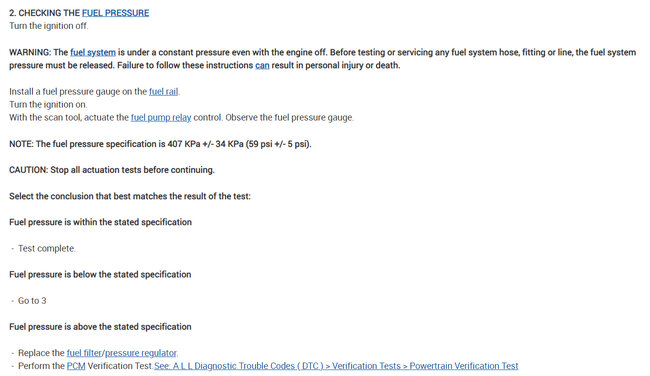

It could be a few things. For example, it could be a fuel pressure-related issue, a large vacuum leak, or even a partially plugged catalytic converter.
When this happens, do you ever notice any odd smells or sounds? Does the engine overheat?
Also, have you checked to make sure the fuel pressure is within the manufacturer's specifications?
Jan 8, 2024 at 10:43 AM
  • 55,402 POSTS

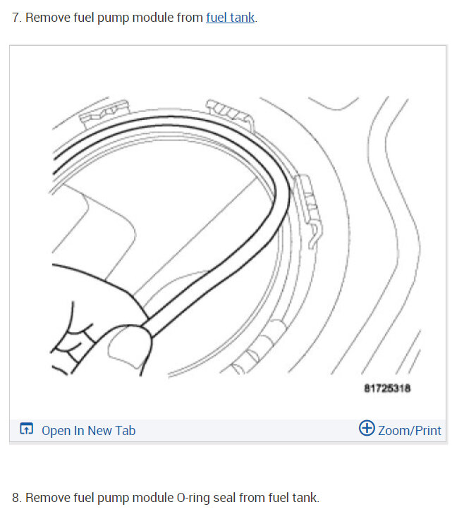

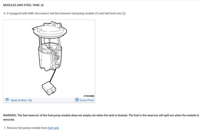

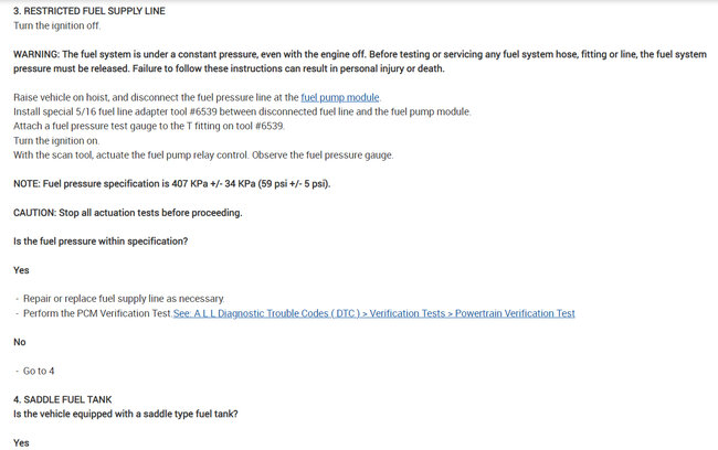

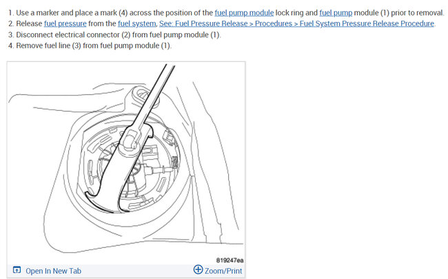

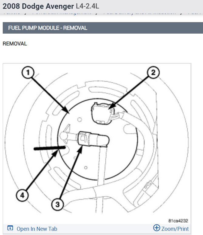

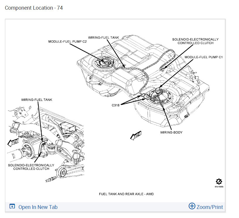

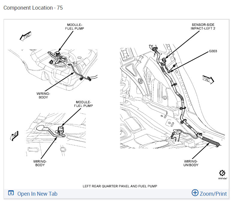

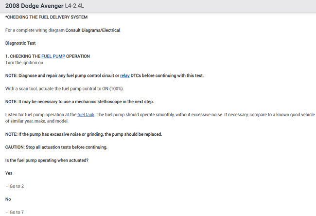

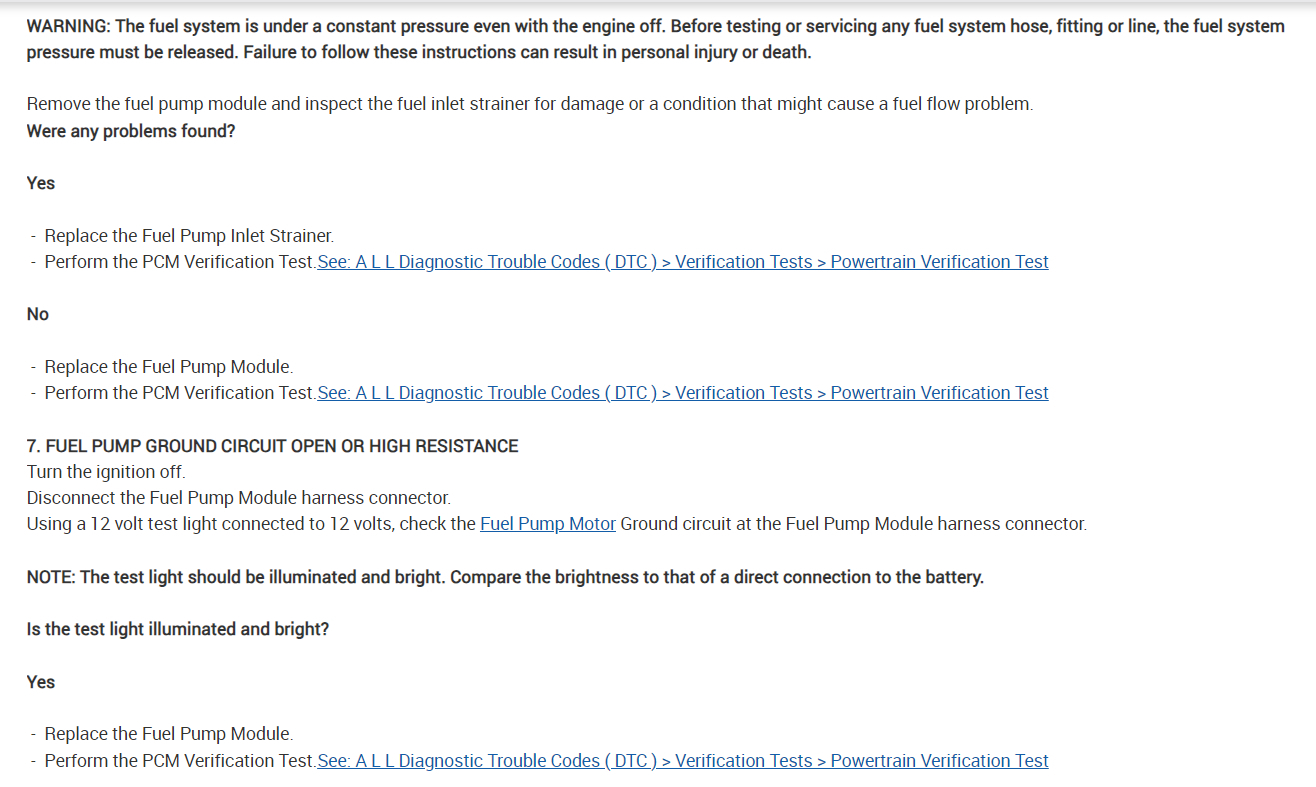

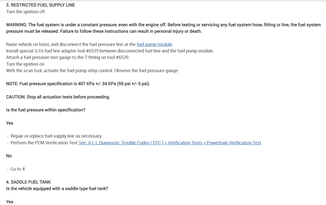

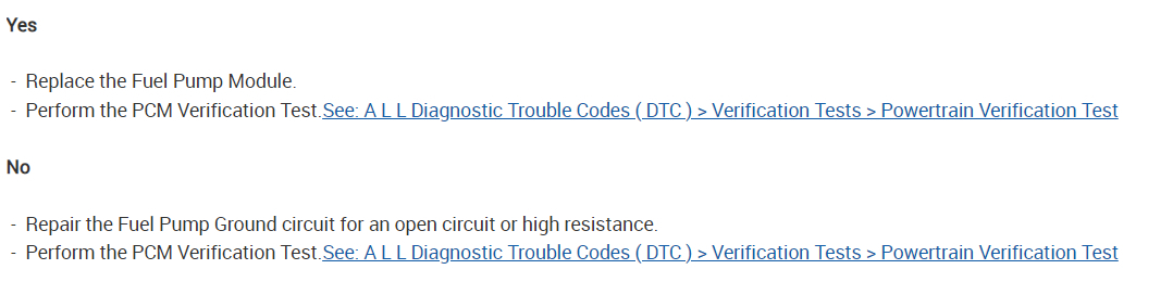

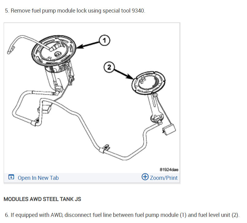

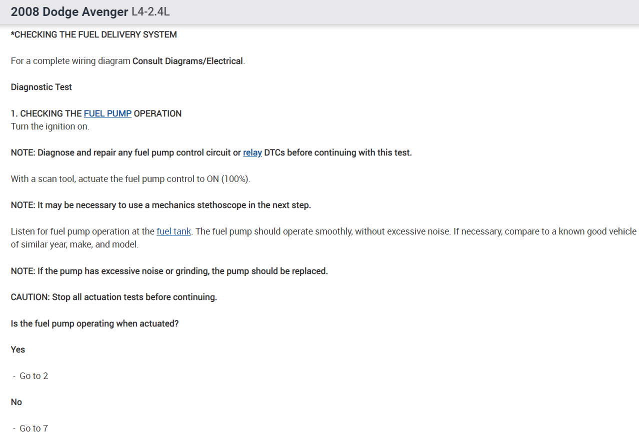

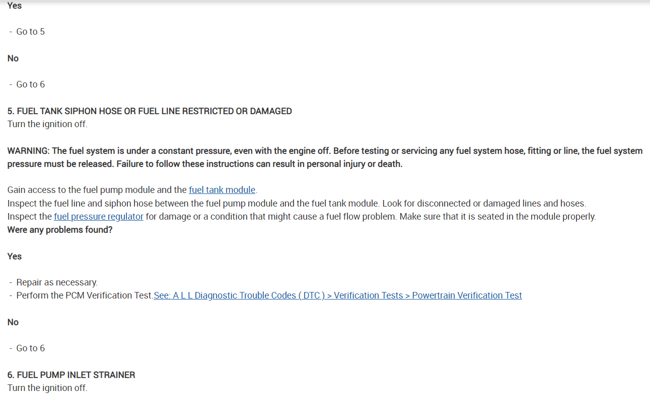

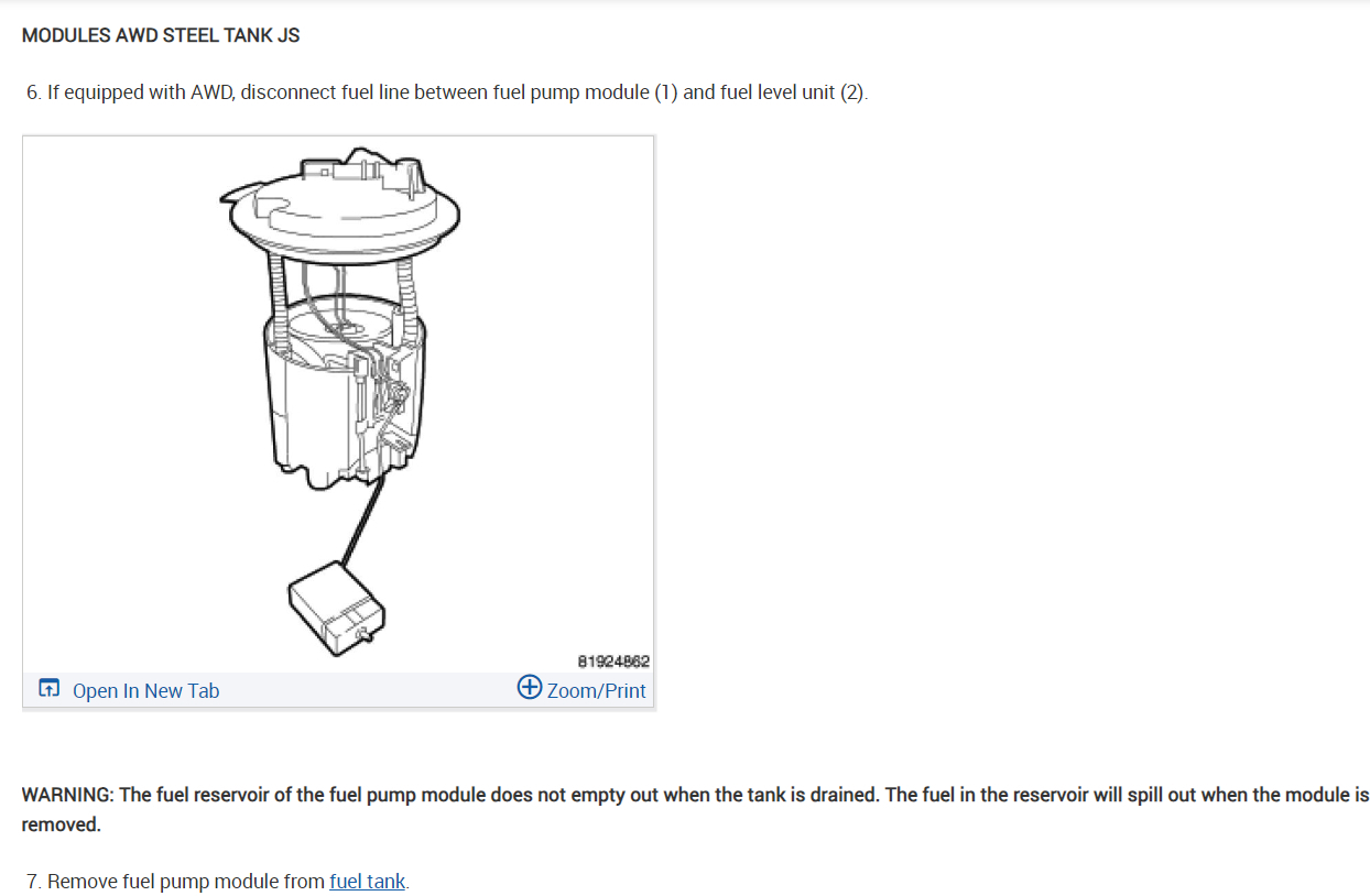

This can be a fuel delivery problem which means a weak fuel pump or a MAF sensor that has gone bad but is not showing any codes which is possible. First, I would check the fuel pressure,
Here is a guide to help with instructions below to show you how on your car:
FUEL SYSTEM PRESSURE
400 kpa ±34 kpa (58 psi ± 5 psi)
Fortunately, the fuel pump can be accessed under the rear seat. I have also seen the TIPM start to go out and cause pretty strange problems as well, but we can tackle that as needed. You can rent a fuel pressure gauge at the auto parts store for cheap or free. Check out the images (below). Please upload pictures or videos of the problem so we can see what's going on.
