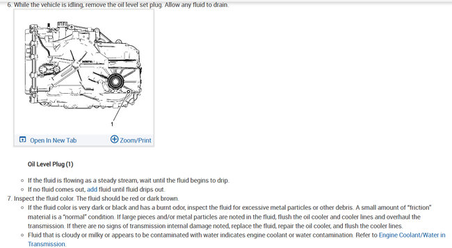

I've noticed this for the past week or so at a cold start, basically after it's been sitting for a while, such as before or after work.
It starts fine, no warning lights on the dash. Shifts into reverse and drive fine. Starts driving normal until about 20mph. Then if feels like nothing is happening. The RPMs go up, but the mph doesn't. Like I'm pushing on the gas pedal but nothing is happening. It feels like it's going to stall, but doesn't. After a few moments it's back to normal and drives fine.

This sounds like an input shaft speed sensor is going out or is not working, also we need to check the fluid level and condition, (burnt or low) lets run the codes to see which ones are stored this video can help.
https://www.youtube.com/watch?v=LBCpCWEFnTg
Here is a guide to help you with instructions for your car as well.
https://www.2carpros.com/articles/how-to-check-and-add-transmission-fluid
