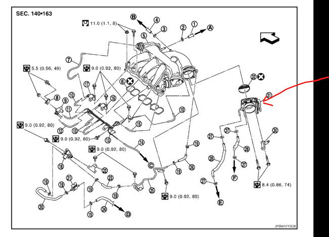

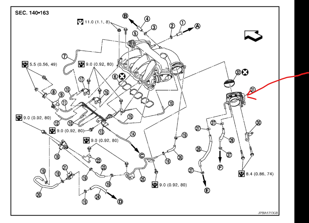

Vehicle will not accelerate in drive or reverse but will accelerate in park and neutral.
May 10, 2023 at 5:01 AM
  • 55,711 POSTS
This is because the car is in limp mode which is usually caused by the throttle bore needing service. Here is a guide to help you understand more and I have included a guide to help you service the throttle bore as well:
https://www.2carpros.com/articles/reduced-power-limp-mode
This guide will help you step by step plus I have included instructions for your car in the images below:
