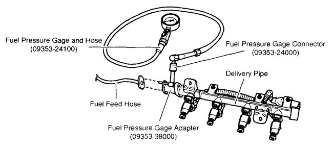

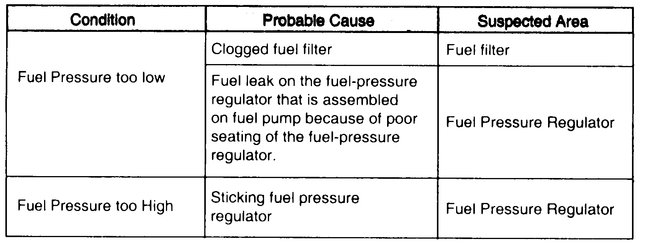

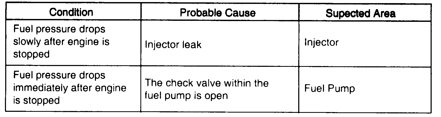

Car hesitation during acceleration, gas fume smell on exhaust, rough idle running okay below 60 but 60 above has jerking.already tried cleaning MAF sensor but did not fix the problem.

If you are smelling raw fuel at the exhaust, first check to make sure the fuel pressure is within the manufacturer's specs. It may be too high.
Here is a link that explains how in general to check fuel pressure:
Here are the directions specific to your vehicle. The attached pics correlate with the directions. Also, the manufacturer's specs are included in the directions.

Fuel Pressure Special Service Tool
pic 1
3. INSTALL THE SPECIAL SERVICE TOOL (SST) FOR MEASURING THE FUEL PRESSURE
1. Disconnect the fuel feed hose from the delivery pipe.
Caution: Cover the hose connection with a shop towel to prevent splashing of fuel caused by residual pressure in the fuel line.
2. Install the Fuel Pressure Gage Adapter (09353-38000) between the delivery pipe and the fuel feed hose.
3. Connect the Fuel Pressure Gage Connector (09353-24000) to the Fuel Pressure Gage Adapter (09353-38000).
4. Connect the Fuel Pressure Gage and Hose (09353~41 00) to Fuel Pressure Gage Connector (09353-24000).
5. Connect the fuel feed hose to the Fuel Pressure Gage Adapter (09353-38000).

4. Start the engine and measure the fuel pressure at idle.
Standard Value: 343 Kpa (3.5 kgf/cm cm, 49.8 psi)
Incorrect Pressure
pic 2
If the measured fuel pressure differs from the standard value, perform the necessary repairs using the table below.
Pressure Drops
pic 3
5. Stop the engine and check for a change in the fuel pressure gauge reading.
After engine stops, the gage reading should hold for about 5 minutes
Observing the declination of the fuel pressure when the gage reading drops and perform the necessary repairs using the table below.
