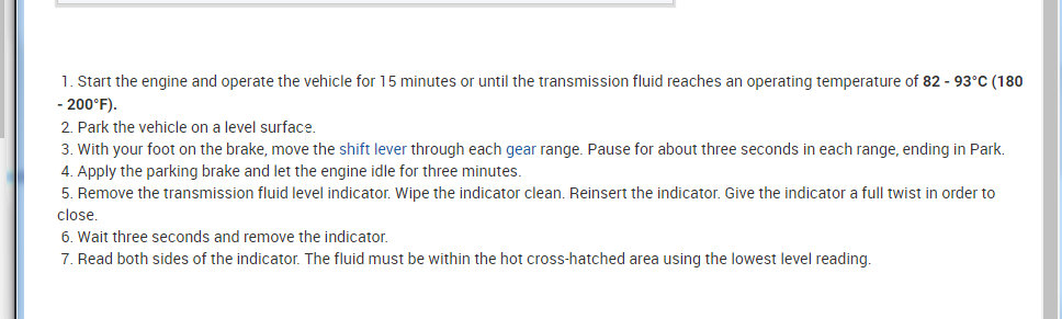

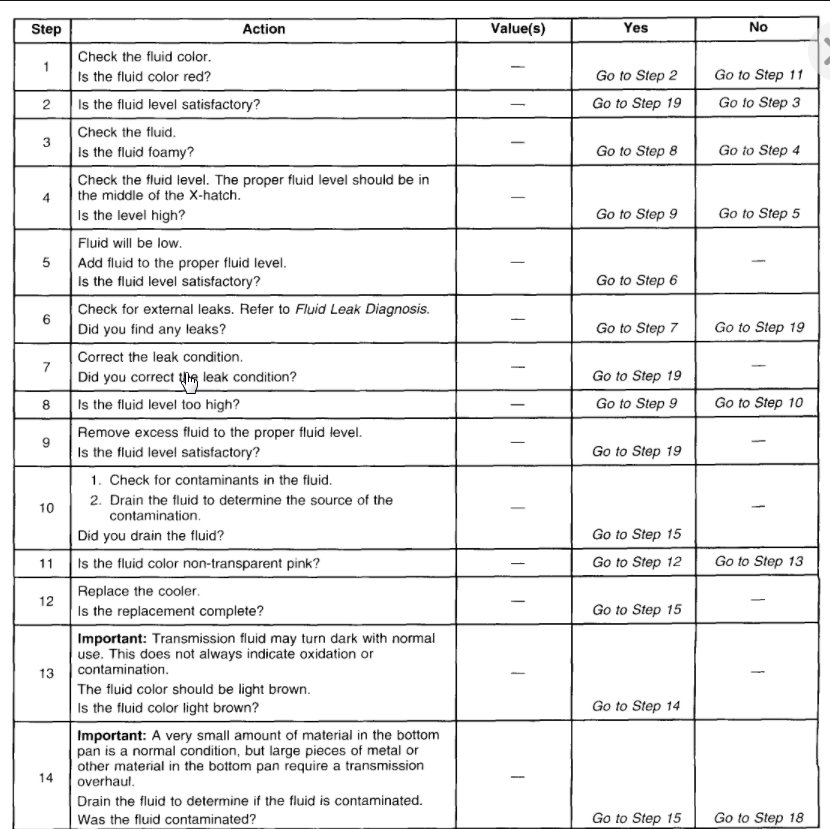

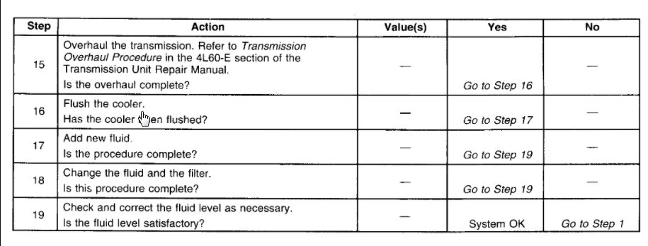

If you do go to WOT, instead of getting completely off the throttle, trying just letting up a little and I suspect it will shift. If this is the case then this is your issue and hopefully new fluid will solve it for you. After you change the fluid you may need to drive it 100 miles before you see an improvement.
I attached below the process from the manual on how to inspect the fluid if you want to review that. Let us know what questions you have. Thanks
