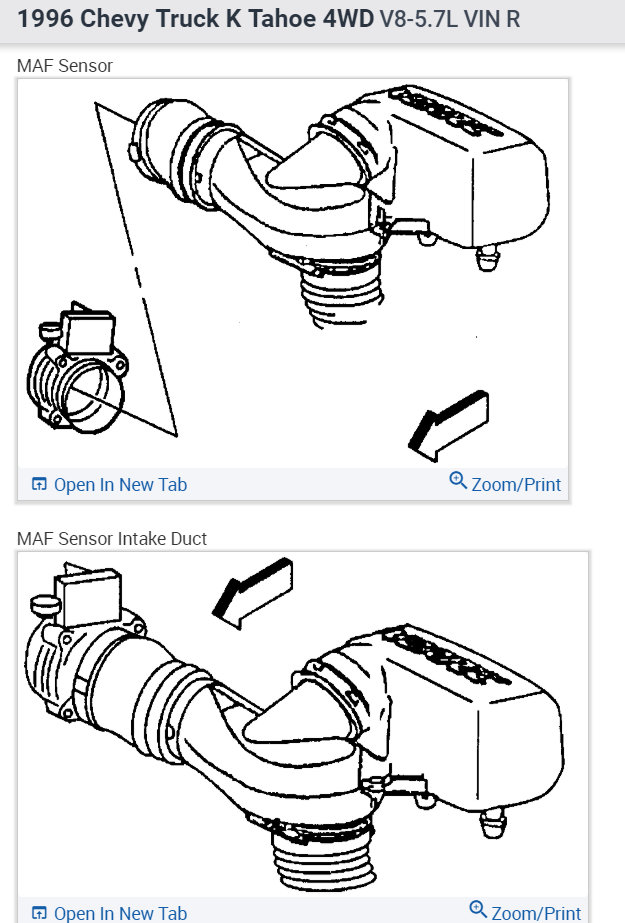

Thanks, you guys, for taking time to answer these questions. My 96 Tahoe is in pretty good shape and I maintain it pretty well. One thing I have noticed it doing is hesitating right when I press the accelerator pedal hard, and then it responds. Is this an injector issue, or something else?

This sounds like a bad MAF sensor here is a guide to help you change it out with a diagram below to show you on your car.
https://www.2carpros.com/articles/how-to-replace-a-mass-air-flow-sensor-maf
This guide can help as well
https://www.2carpros.com/articles/engine-hesitates
Friday, July 31st, 2009 AT 4:30 PM
R MCELHANEY
  • 0 POST
The MAF fixed it I got a new one for $78.00
