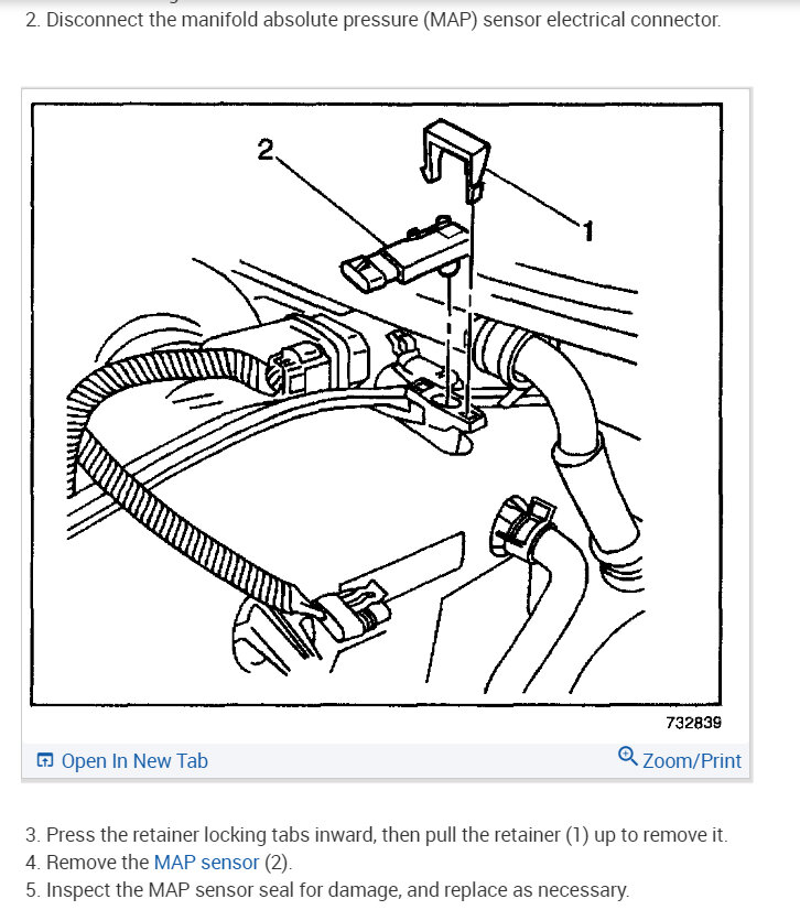

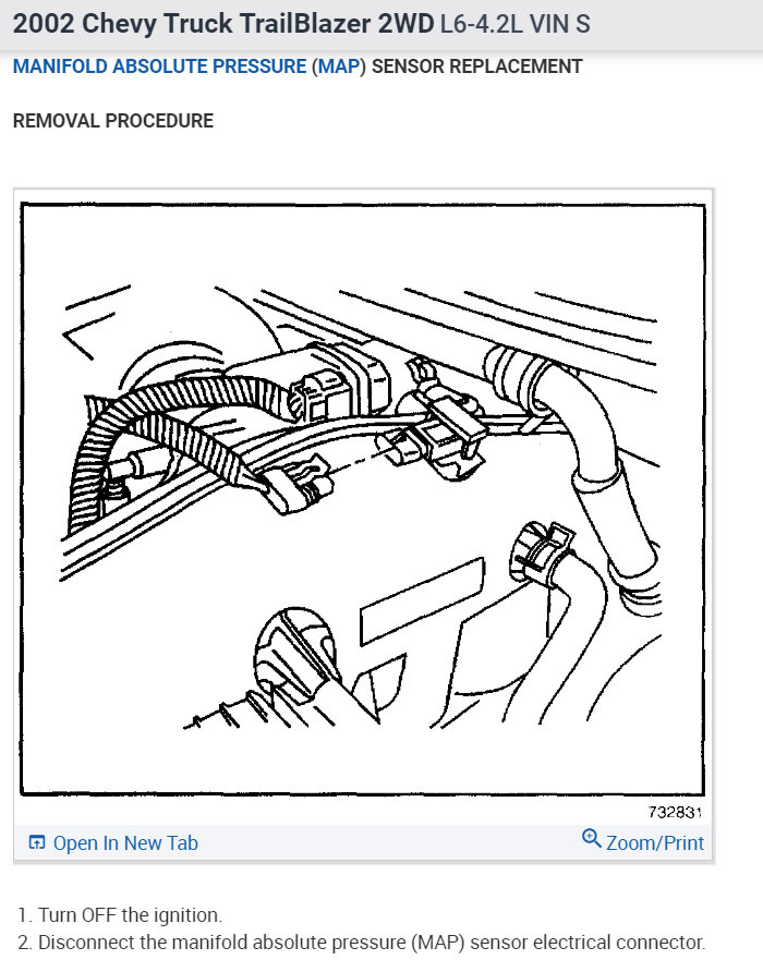

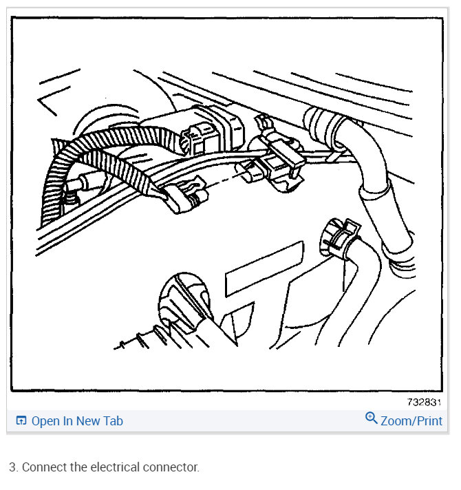

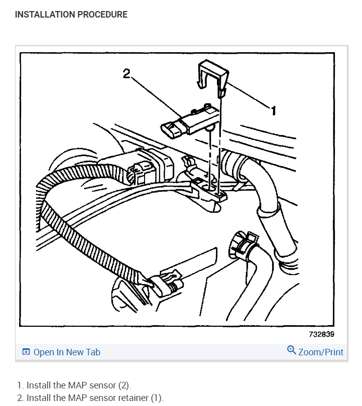

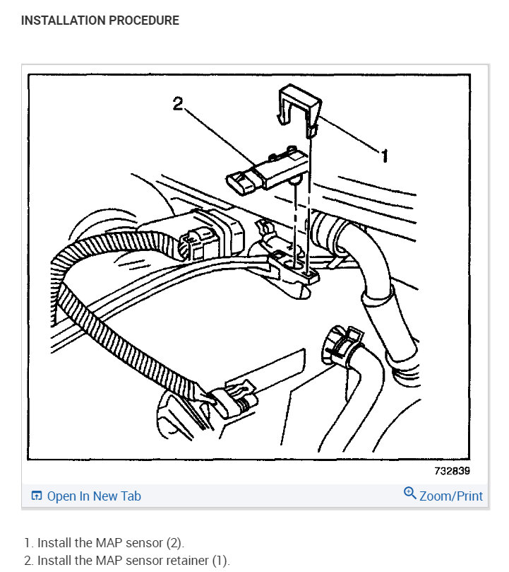

It sounds like you have a clogged exhaust system or the MAF sensor is bad, here is a guide to help you check the exhaust for blockage:
Here is the location of the MAP sensor so you can swap it out. Also is the engine misfiring when accelerating? Please check the air filter as well. Check out the images (below). Please let us know what happens.

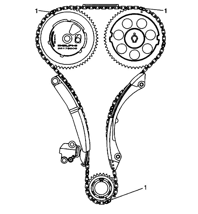

Did you check the air filter? Also, when the engine is idling do you hear a rattling sound from the front of the engine? Can you upload a video of the engine idling and then rev it once so I can see, I think you may have a timing chain that has jumped. Check out the images (below). Please let us know what happens.
