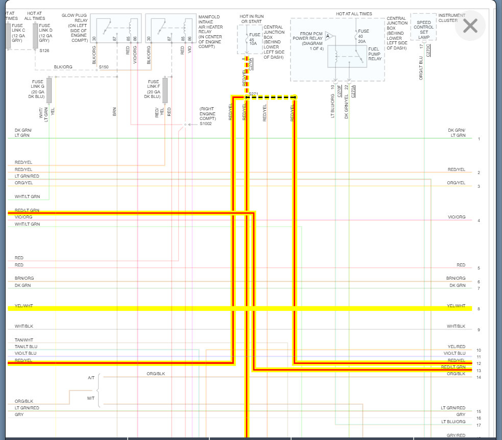

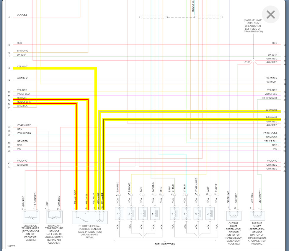

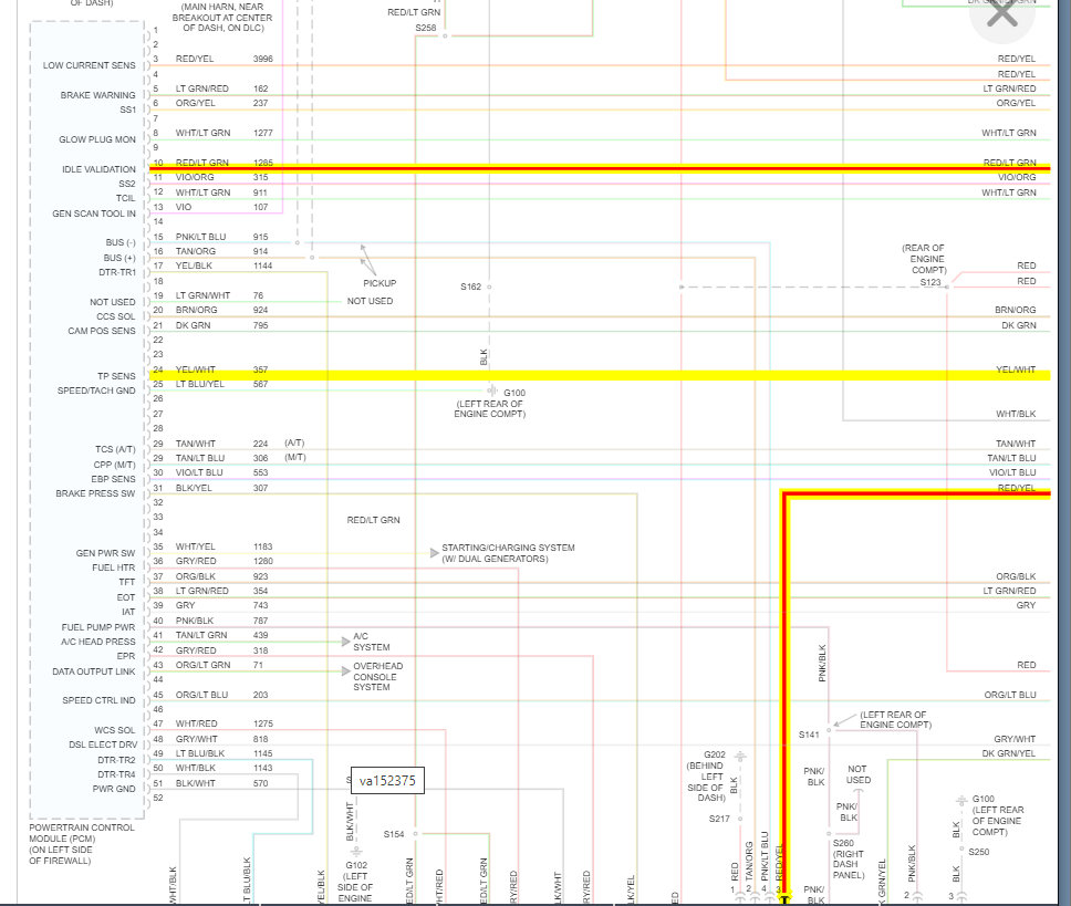

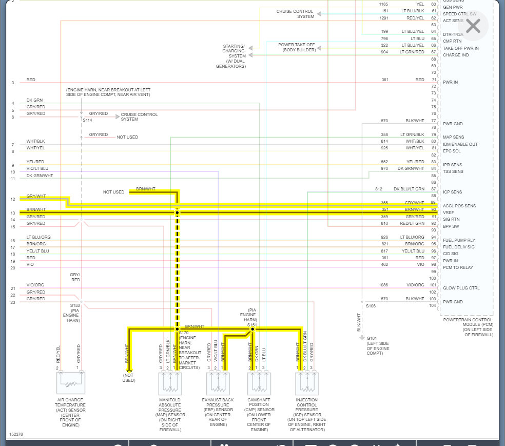

Acceleration I changed my pedal on my truck and still no response it starts right up but when you push pedal still nothing.

If the RPMs do nothing, then we need to do two things. First is check for codes.
We should have codes pointing to the pedal or throttle position.
I am attaching the wiring diagram info on throttle which we are going to have to check to find out if the PCM is getting the throttle input.
