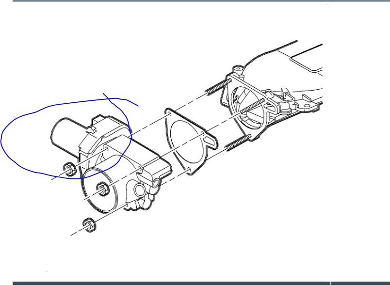

The sensor is part of the throttle body and cannot be replaced without replacing the entire throttle body.
Why are you thinking you need the sensor? Is there a code?

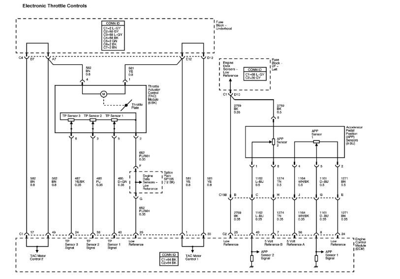

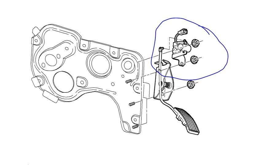

Okay, how do you rev to 4 grand if the plate does not open?
If the throttle body is bad, it should code.
There is also a pedal sensor that controls throttle. I attached a picture of it.
You will need a real scan tool to monitor the voltages of the system to find the failure.
