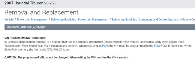

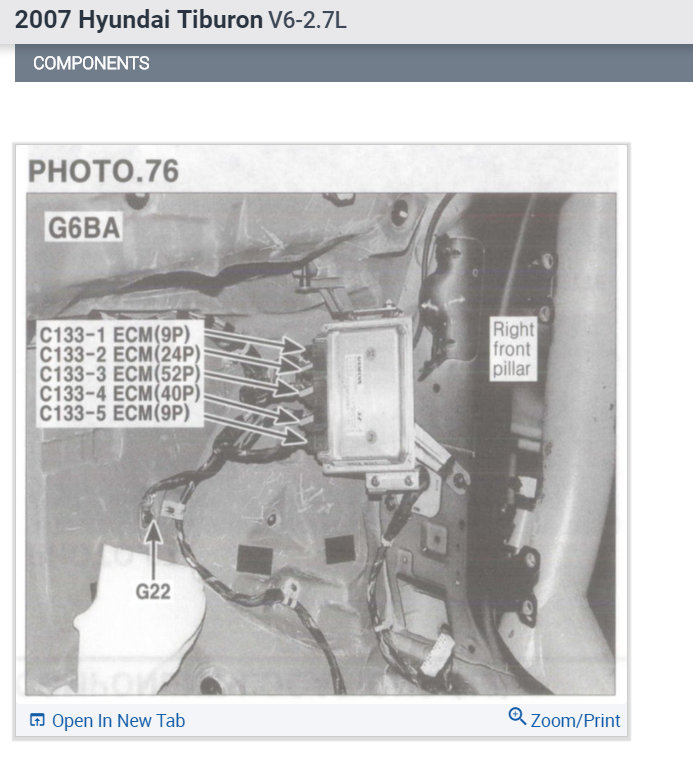

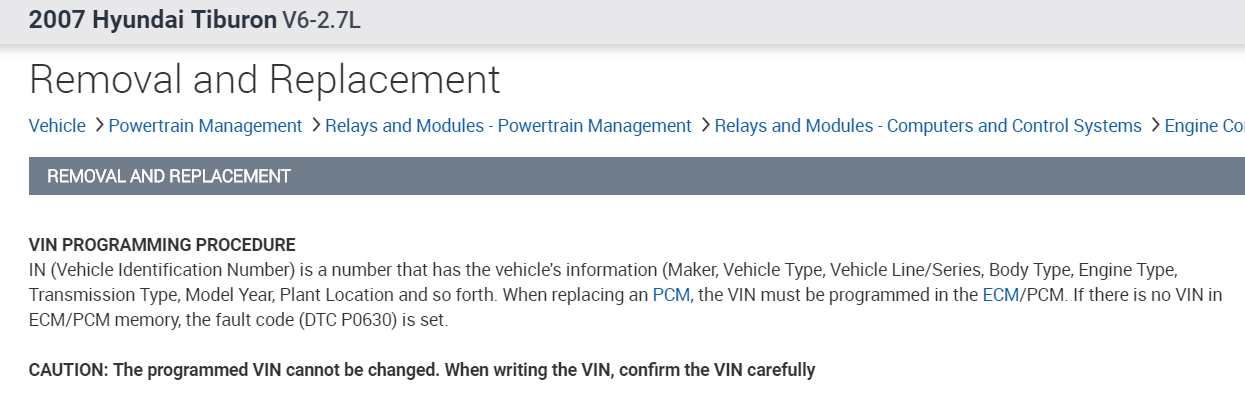

It sounds like you are setting the computer each time the malfunctions start, this can be a sign the PCM is bad and needs replacement. here are instructions and diagrams to help. Check out the diagrams (below). Please let us know what happens.
