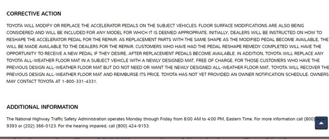

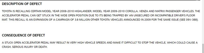

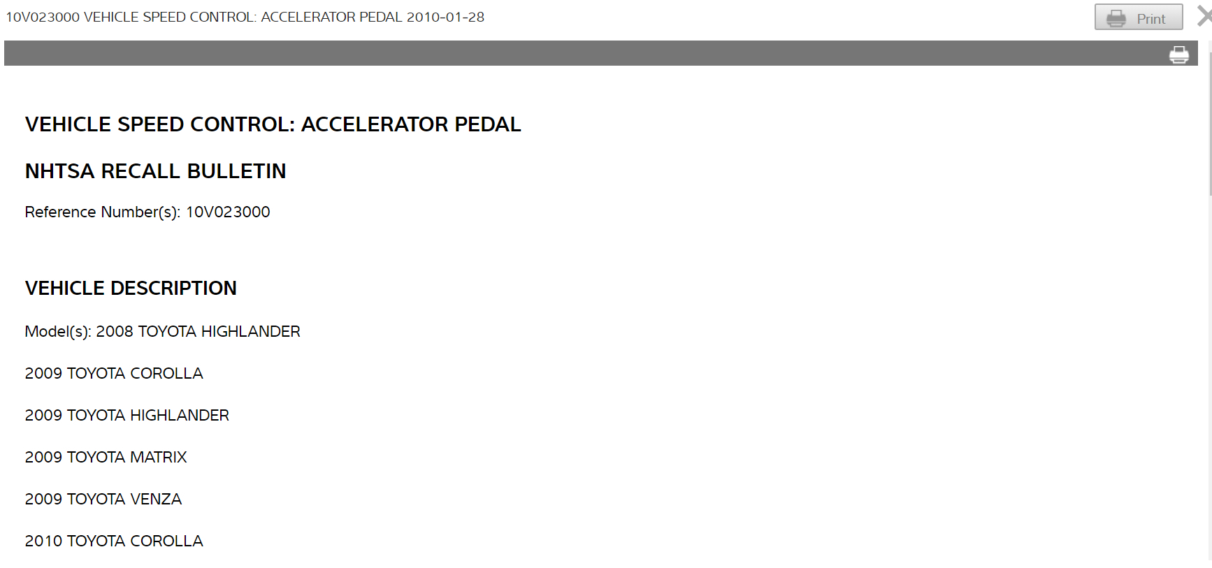

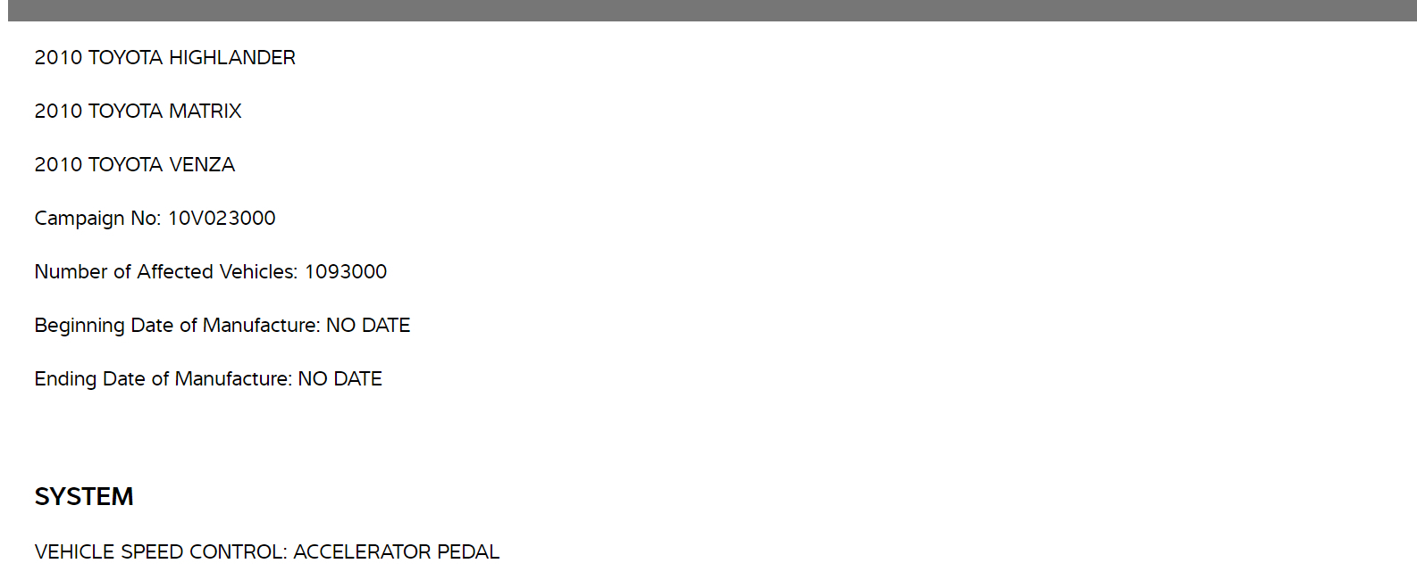

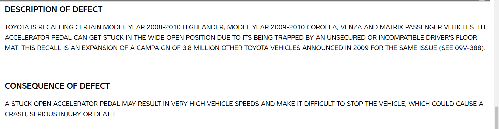

There is a Safety Recall for your vehicle about this issue. I have included the Safety Recall Bulletin in the diagrams below. It contains a 1-800 number to call Toyota to schedule a time to get it repaired free of charge.
