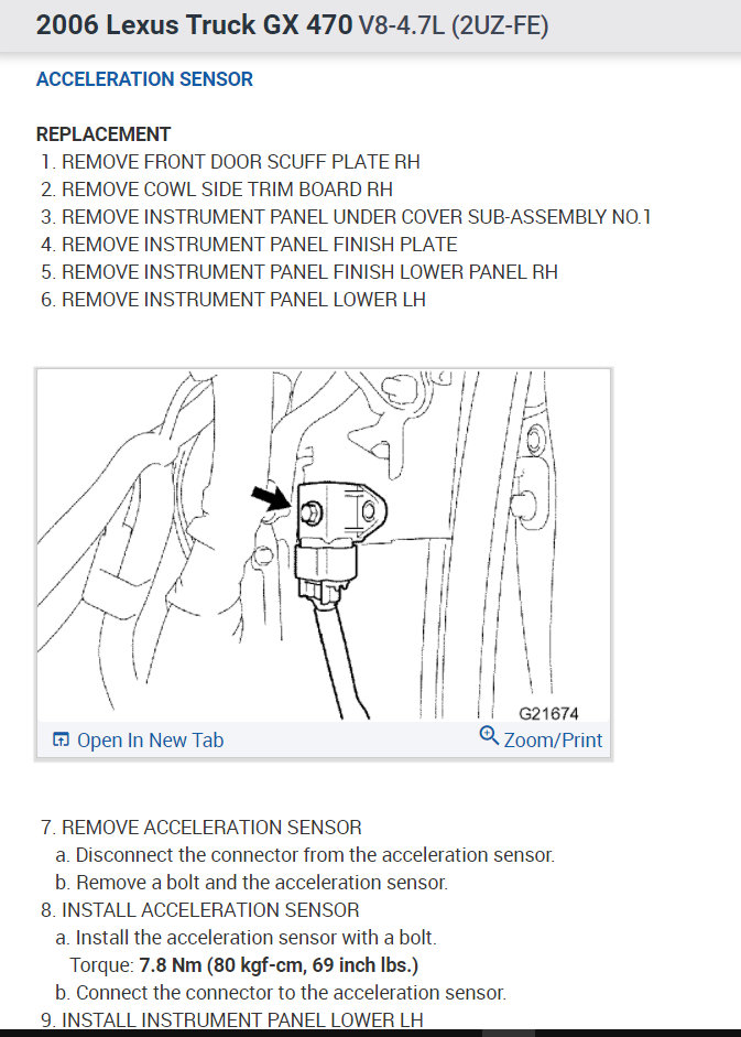

Can the original rear acceleration sensor part No: 89190-44010 be substituted by 89190-60030 or 89191-50020 or any other part no?
Sep 20, 2017 at 7:43 PM
STEVE W.
  • 15,295 POSTS
Neither of those will fit.
Toyota/Lexus parts shows # 89190-44010.
Airtex shows 5S9456.
Wells shows SU10918.

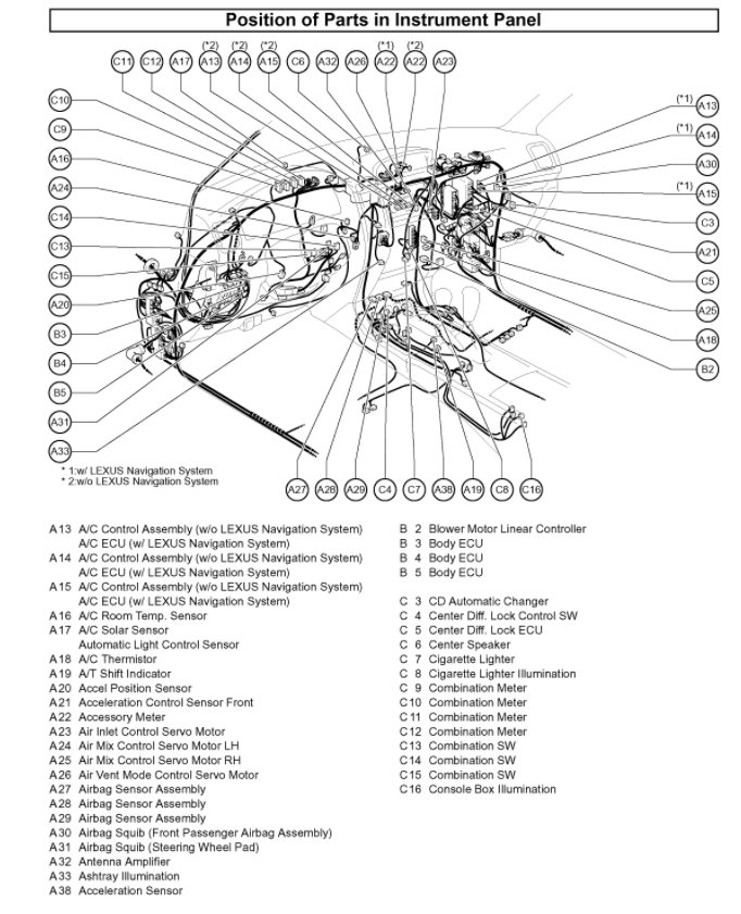

Check out the diagrams (Below) for the acceleration sensor. Please let us know if you need anything else to get the problem fixed.
