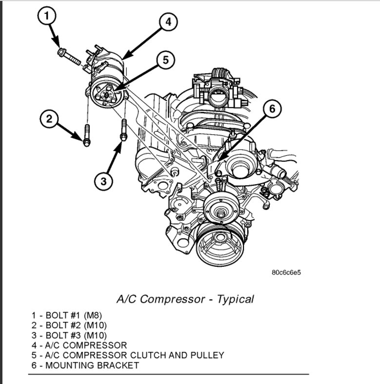

So I have been having a A/C problem and it is blowing my mind.
One day I can start it up and A/C blows cold and compressor runs and the next day compressor will not kick on . Later that day works fine. Two days later compressor will not kick on. Just trying to show how random it is. when it runs I have checked on gauges 40 low, 300 high, 99 degrees with eighty percent humidity.
Would love some input on this.

It sounds like you have a compressor coil going out. When the compressor is not kicking on check the power wire with a test light.
Here is a guide to help you:
If the compressor is getting power but not engaging it needs to be replaced here is a guide on that as well.
https://www.2carpros.com/articles/replace-air-conditioner-compressor
Diagram for your car below.
Please let us know what happens, we are interested to see what it is.
