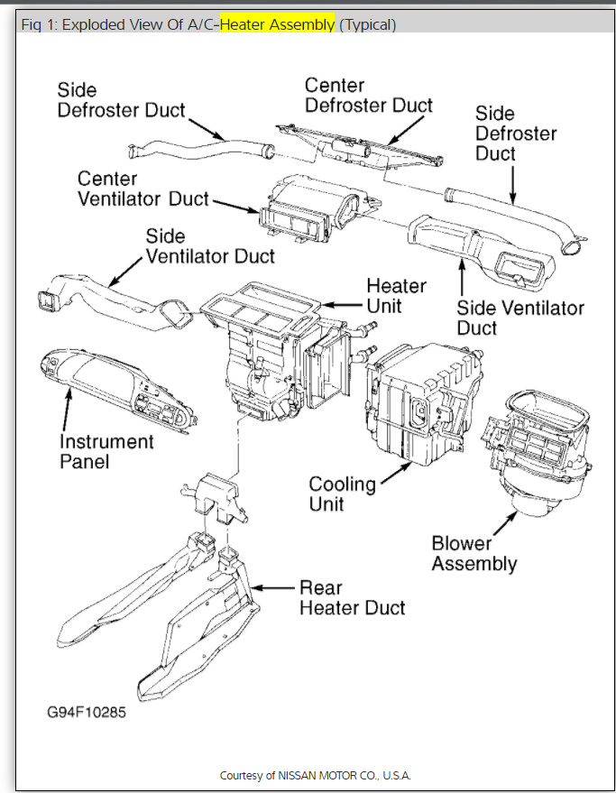

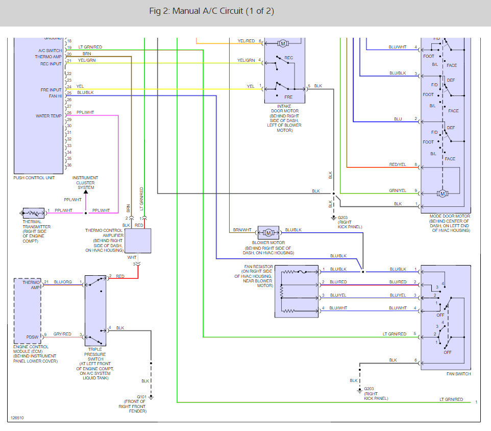

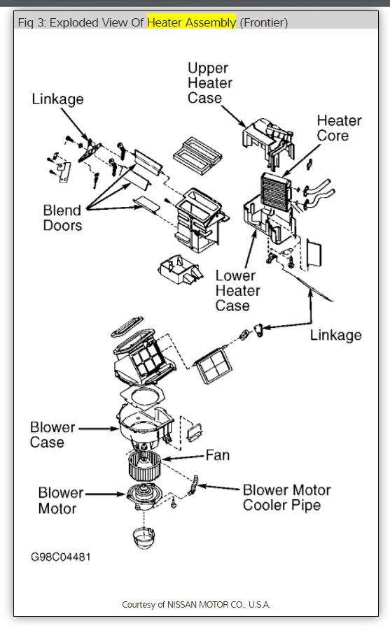

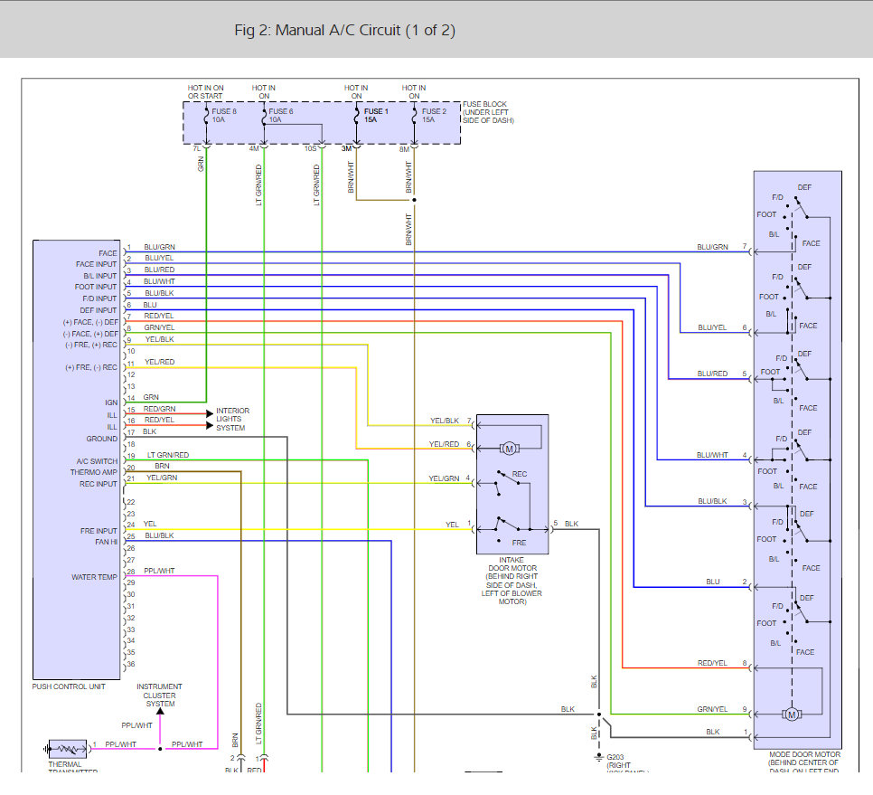

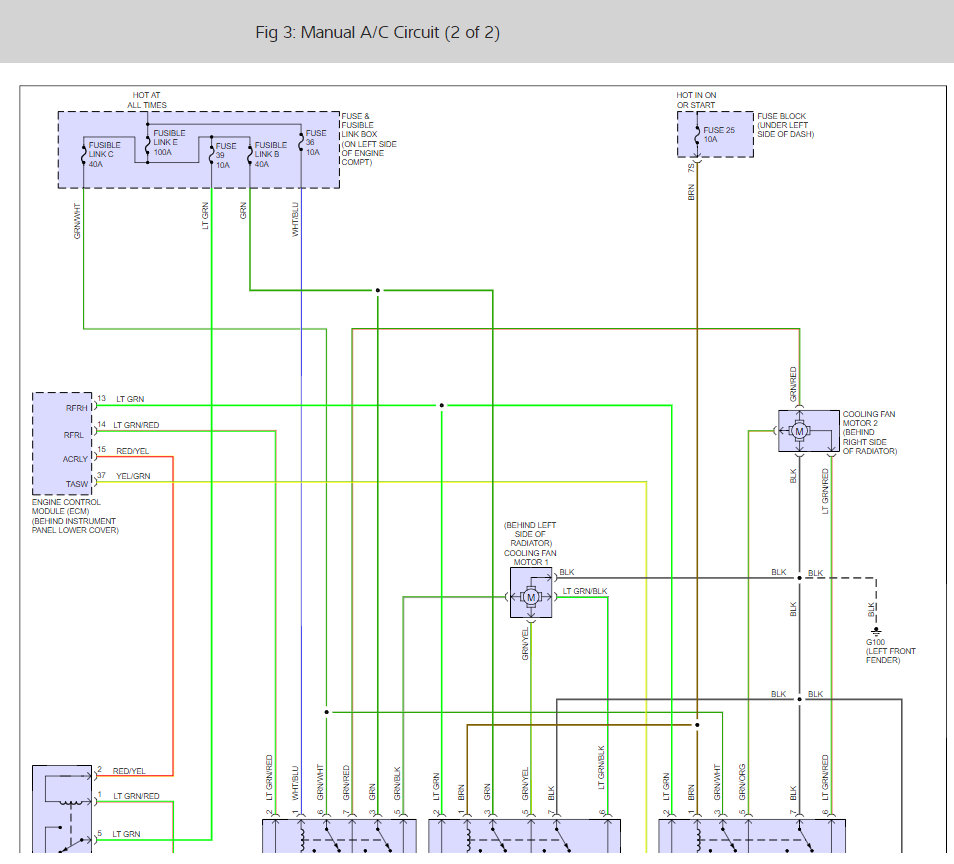

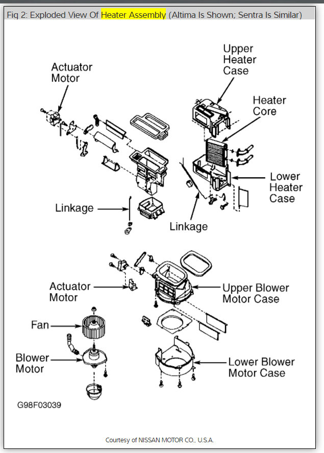

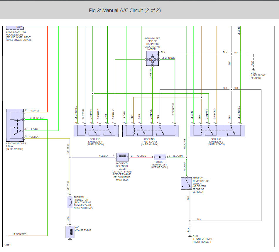

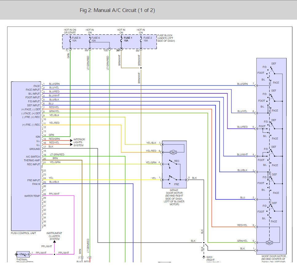

Here are some guides and some diagram (below) that will help us get the problem fixed. Check it out (below)
Cheers

yeah, this could be one of the sensor but I don't have specs. For testing this thermo cntrl amp? And i'm a bit lost of this system coz when they call it thermo cntrl amp. This must be a module with printed broard, chips resistor ect. In the small box connected to the harness, and when I check it, its only three wire harness that go in to the a/c evap housing I don't know what on the end of this three wire . Like older nissan I see a small box stick on the side of the evap case call it thermo cntrl amp, and also this nissan altima was made MAY. 2001 may be we barcking the wrong and get the wrong info. Pls help thanks fixsky
Tuesday, May 25th, 2021 AT 11:15 AM (Merged)
JAMES W.
  • 2,394 POSTS
We have a lot of problems with import(Japanese) wiring diagrams not matching what is actually in the vehicle. Many times we just have to read between the lines. Usually, unless you have the diagnostic unit, there is very little the owner can do to isolate an electronic problem. You can use the"well that didn't fix it, let's try this" approach, but that can get expensive.

Looks like I have the same issue as you described and your solution seems to perfect fix for mine. I would like to get information on the following:
1. Where exactly is the Evap Housing Located on the Altima?
2. Where can I buy the Temp Control Amp? Please provide any part #, if you have it.
3. Does this fixing need any special tools?
Thanks in advance.
-Jay
JAMES W.
  • 2,394 POSTS
The evaporator is under the dash in the same box as the heater core. No special tools required, it's just a miserable bugger to get at.
