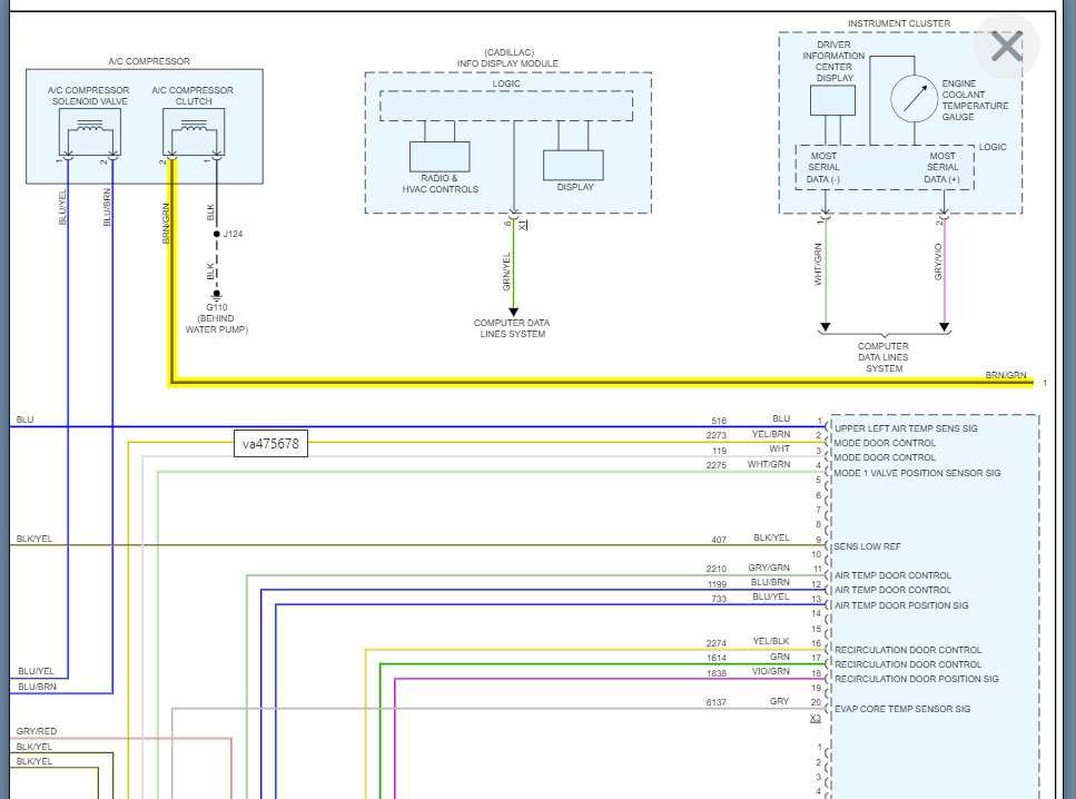

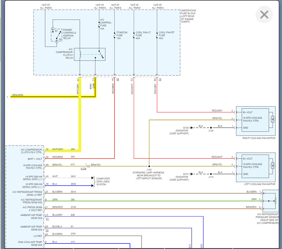

I am not sure which relay they are talking about, but I assume it is the specific compressor relay.

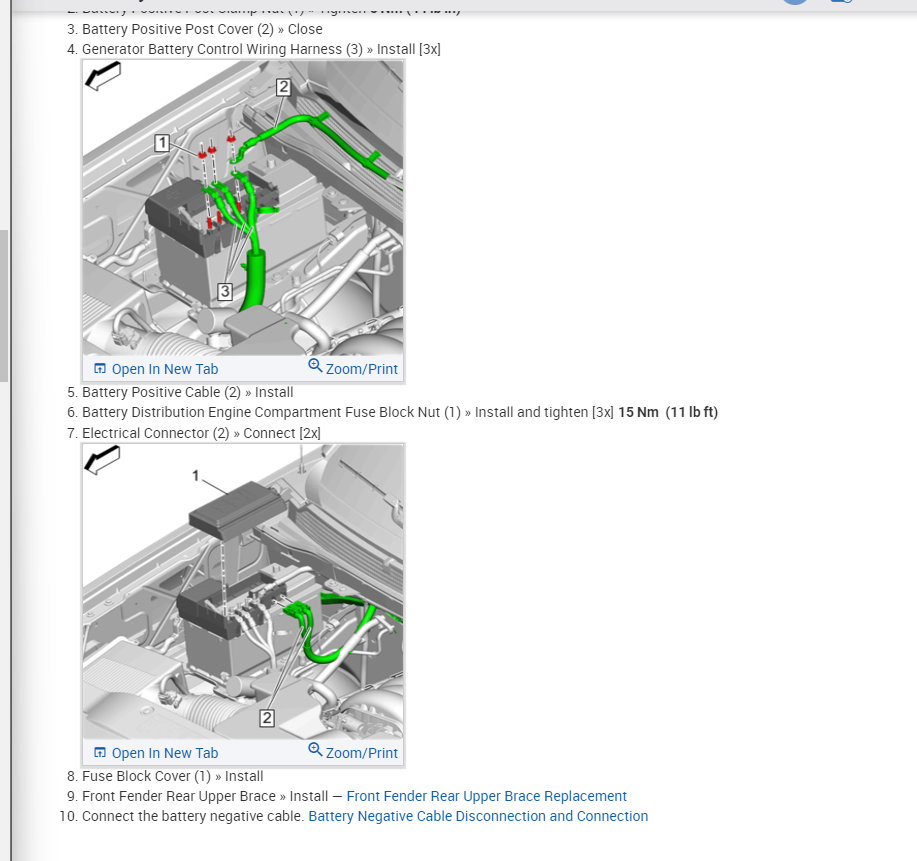

If this is the case, then I am attaching the info for this relay. As you can see this is part of the under-hood fuse block which I am attaching the info below for this.
However, I am concerned that this is not the issue based on this info. Where did they measure the resistance of this relay? Was the relay engaged when they took this reading?
They could be correct, but I would just want a little more proof of this before agreeing to it or get them to agree that if this does not fix it then you do not have to pay for this repair.
Please see the info below and I would get a part number of what they are saying needs to be replaced just to be sure this is what I attached.

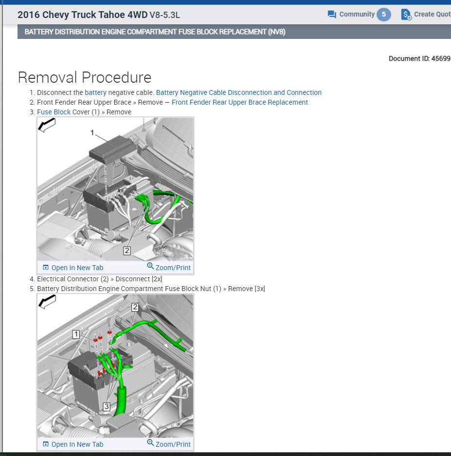

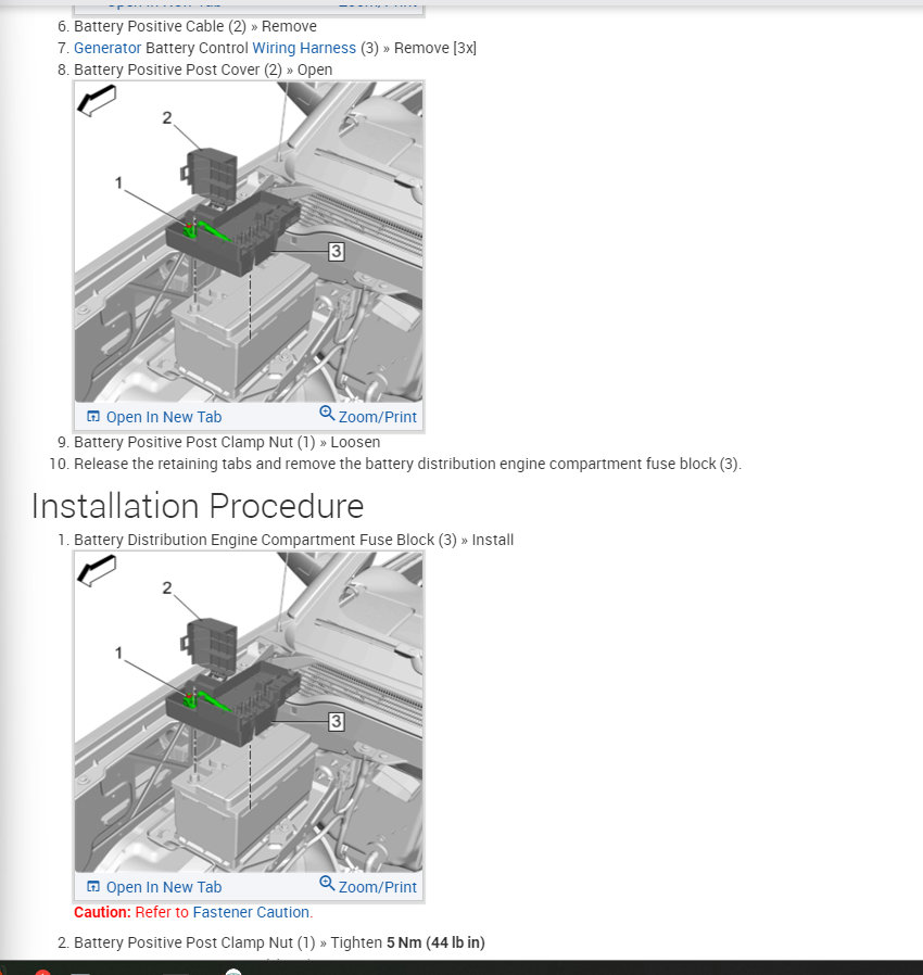

That does appear to be the same part that I supplied the process for. So, if we trust their diagnosis then let me know if you are going to try this based on these instructions.
Let me know if you have questions. Thanks
