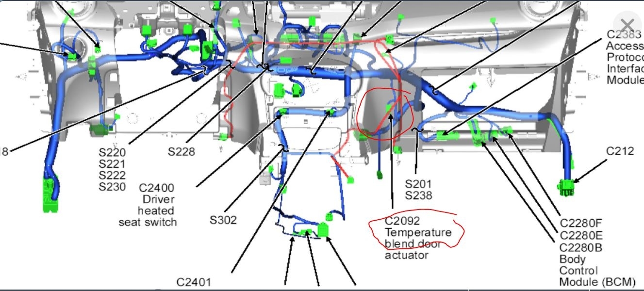

A/C is working, blower is also working but the air is not cold even if taken at 16°C .
What could be the problem?
I am scared that it would be a major and costly issue.
Please help.

The first thing I would do is check the high and low side pressures. I need to see those pressures to be sure the A/C system is working correctly.
It could also be a blend door actuator but needs to be confirmed. I would check the Freon system first.
Temperature Blend Door Actuator
1. Remove the instrument panel. For additional information, (SEE Instrument Cluster / Carrier and/or Interior Molding /Trim).
2. Disconnect the temperature blend door actuator electrical connector.
3. Remove the 2 temperature blend door actuator screws.
4. Remove the temperature blend door actuator.
5. Note: When installing the temperature blend door actuator, be sure that the actuator gear, and the blend door gear are aligned so that the center (keyed) portion of each gear mates with the center (keyed) portion of the opposite gear as the gears are rotated.
To install, reverse the removal procedure.

Okay, I will be happy to as soon as you tell me the failure. I told you what needs to be checked.
If it is the blend door I would estimate it at about $140.00 to $160.00 parts and labor.
If it is the Freon system, the evacuate and charge the system would be from $150.00 to $200.00.
Sep 29, 2020 at 11:30 AM
RATHODSANDESH25
What if the gas is empty?
How much would it cost?
Sep 29, 2020 at 11:12 PM
As I stated in my last response, it would be $150.00 to $200.00.
If it is empty, then you have a leak and that must be determined and repaired.
