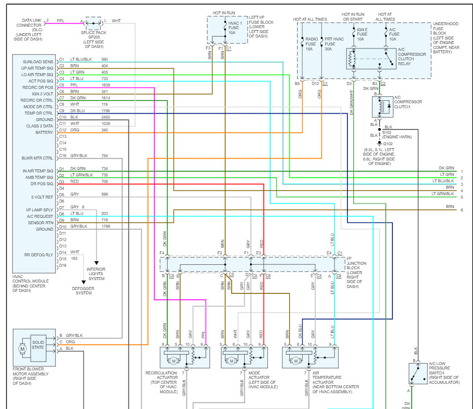

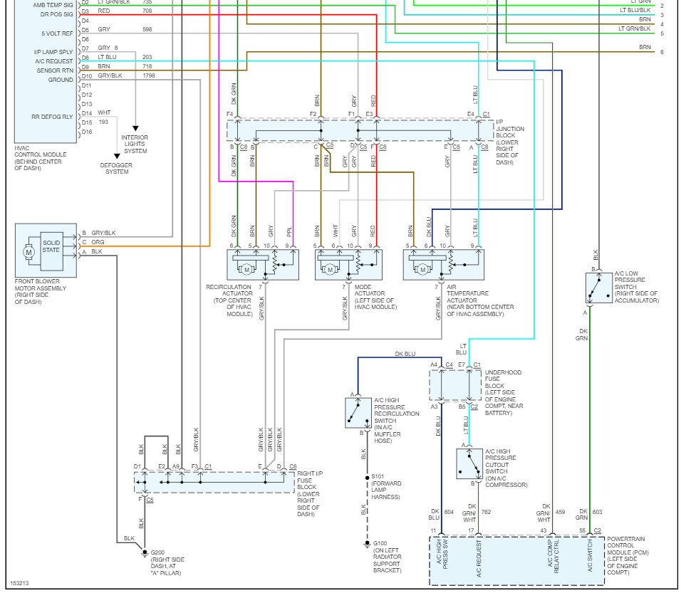

I have replaced the A/C compressor; the climate control unit and the A/C compressor clutch will not work unless the relay is jumped. I think it's pins 85 and 30 that are being jumped but I'll have to check to be sure. I know for a fact I'm not getting a ground in pin 85 which I'm guessing activates the ac clutch. Also, the A/C light on the climate control only blinks 3 times when pressed to turn the A/C on. When using a scan tool the A/C can be requested on and it the compressor clutch will engage.

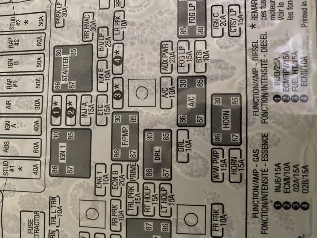

Also, what is weird is that every schematic I look at has pin 87 under pin 30 but in the under the hood fuse box diagram the 87 pin is under pin 86 and pin 85 is under pin 30. The pins 87 and 85 are flipped causing me mass confusion.

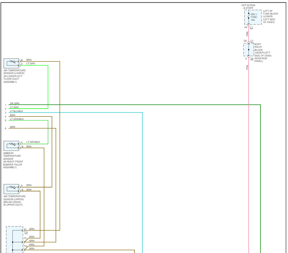

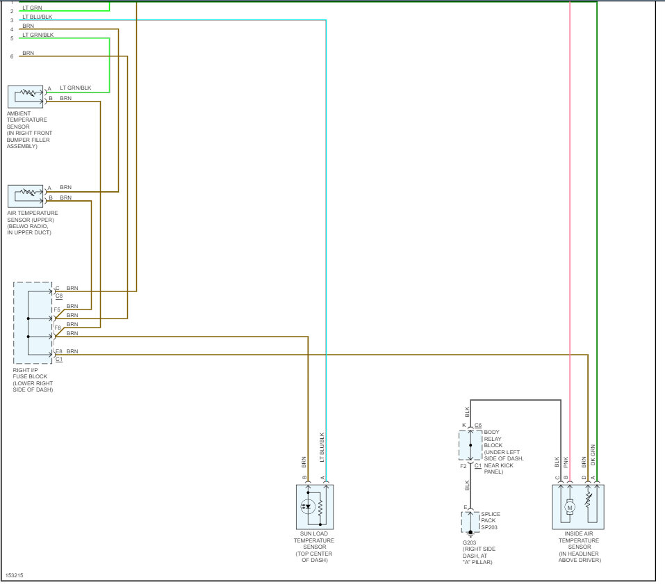

Here are the A/C system wring diagrams so you can see the grounds and fuses that run the system and you can see how the system works. This guide can help you test the connections:
Check out the images (below). Please let us know how it goes.
