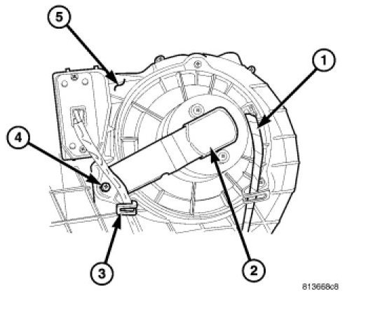

Air conditioner/heat will not come on. I turn the knob on the control panel to on and I get nothing. Use to tap dash and it would come on. When it came on it would blow fine then would get lower as I drive along like as if I turned it down until it would not blow at all. When it blew low I could hear a fan like it was struggling to turn. What could this problem be? Please help it is getting hot in here!
Apr 30, 2017 at 2:08 AM
  • 55,381 POSTS
This sounds like you have a blower motor that is going out, Here is a guide and a diagram that will help you get the problem fixed.
https://www.2carpros.com/articles/blower-fan-motor-works-on-high-speed-only
Please run this test and get back to us so we can continue helping you.
