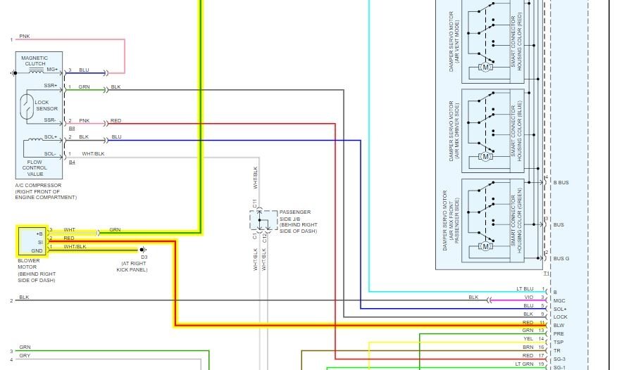

It does sound like a blower motor or connection at the blower.
https://www.2carpros.com/articles/blower-fan-motor-works-on-high-speed-only

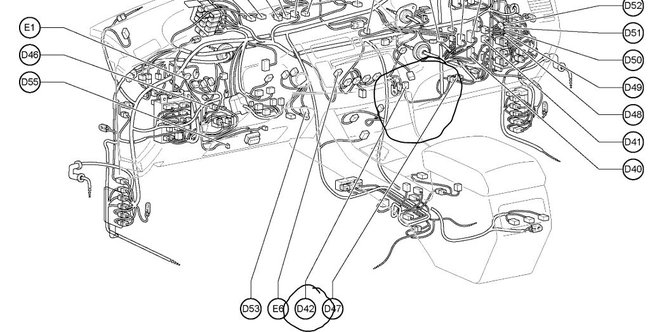

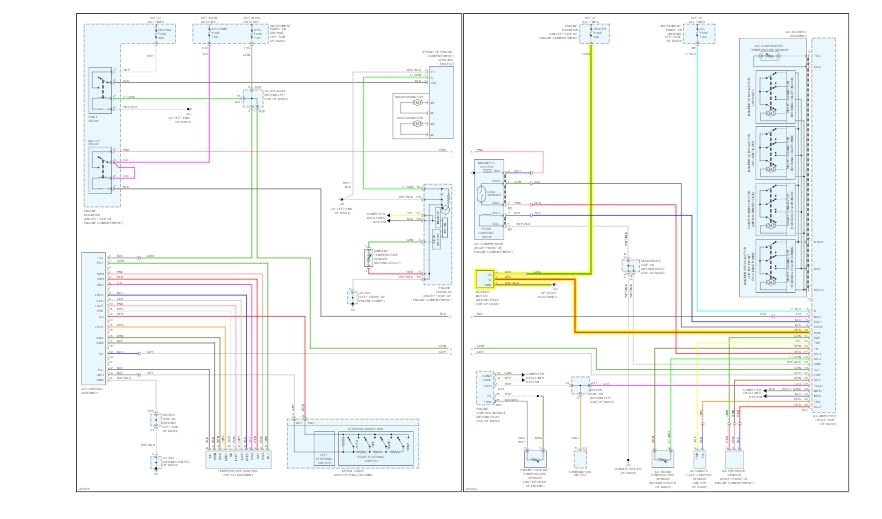

I attached a wiring diagram for you to check the voltage with a voltmeter to see if the voltage is getting to the motor.
