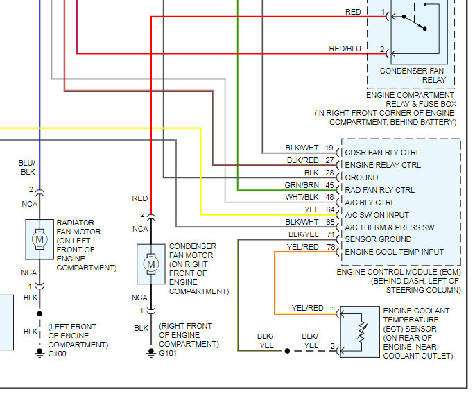

So what he does is totally bypass the connection of my ac clutch from the ECM.

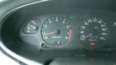

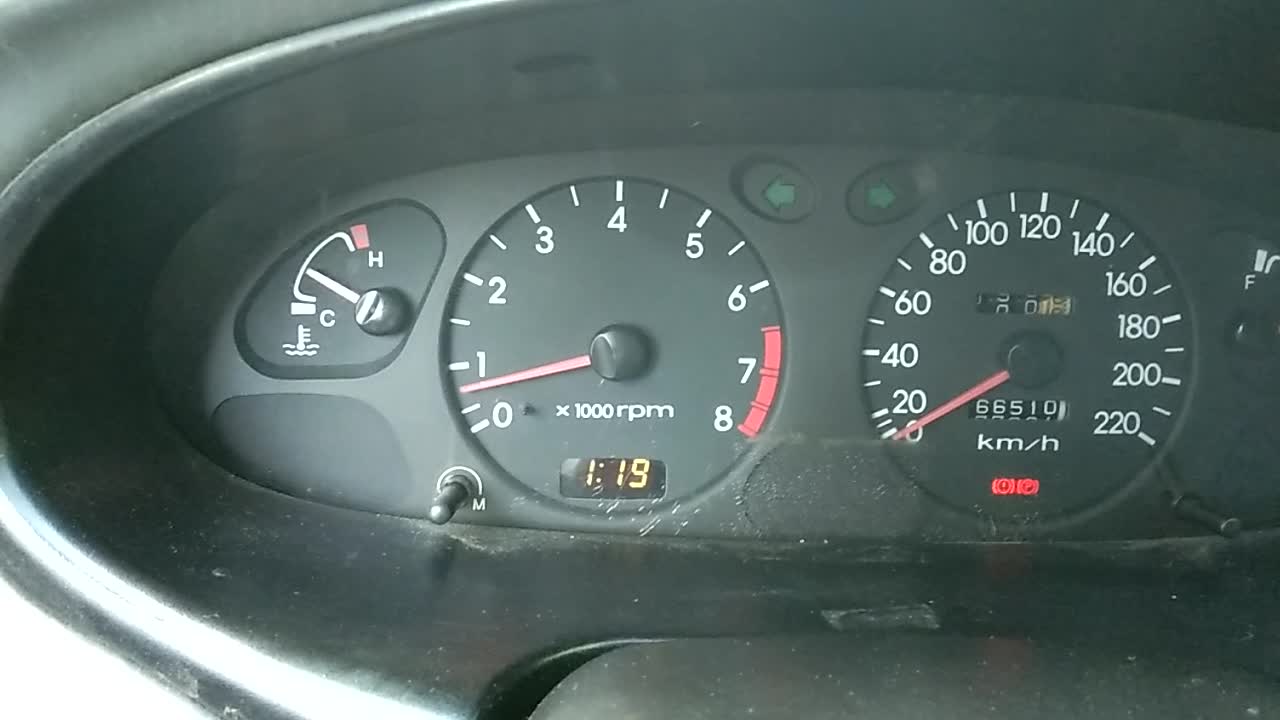

Whenever my A/C clutch kicks in, my rpm momentarily drop to almost 200 then goes back to normal rpm 800-1,000 rpm and sometimes stalling the engine.
My question is, how can i reconnect it back to my ECM? I don't know where the pins of A/C clutch relay and A/C switch on the ECM.

Right now, my main target is to reconnect back my ac clutch to the ECM. So that the computer will bump the IACV to increase whenever the A/C clutch kicks in. I need to find the wires of my A/C clutch, A/C switch, and A/C pressure switch.

Things I notice is that i still see a timely increase of rpm (150-200 rpm's) in like every 2 minutes as if the computer is thinking that A/C is still connected. But the increase of rpm is way to early since A/C clutch kicks in after 10-20 seconds.

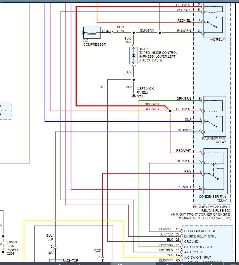

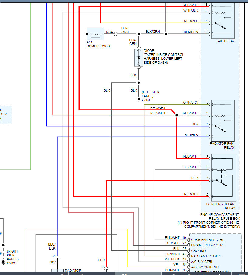

Not sure why I didn't think of this before. The ECM knows when it is going to kick on the compressor so it can pump the idle if needed. Now you are just getting an added load to the engine and it doesn't compensate.
Is there a reason he did what he did? Why was it bypassed? I included the wiring diagram. We need to wire it back the way it was or take it back to him and have him undue what he did.

Any idea how I can test each wires to see if they are really for A/C system? I checked the wires earlier today and it's a lot of wire under the steering column.
Feb 3, 2020 at 6:52 PM
You can test each wire but the way to do it is very cumbersome and not easy. Basically you have to check for what is called continuity from end to end. This will tell you if the wire is where it is supposed to be.
It can be done but if it were me, I would take it back to him and tell him to put it back the way it was so that you have the original issue unless the head light issue is repaired. I have no idea why he would decide to cut some wires out and then hard wire the A/C clutch. Does this person own a shop or was it just someone doing it as a side job? If they have a shop, I would take it back.
Otherwise, I will get you the complete wiring diagram and you will have to check continuity as I stated earlier. I am just trying to save you a major headache because trying to figure out what someone did without a wiring diagram is the hardest thing to do in automotive work. Wiring is complicated as it is when you have a diagram that tells you exactly what wire is where. Without knowing everything they did, you will need to trace it and that is difficult.
