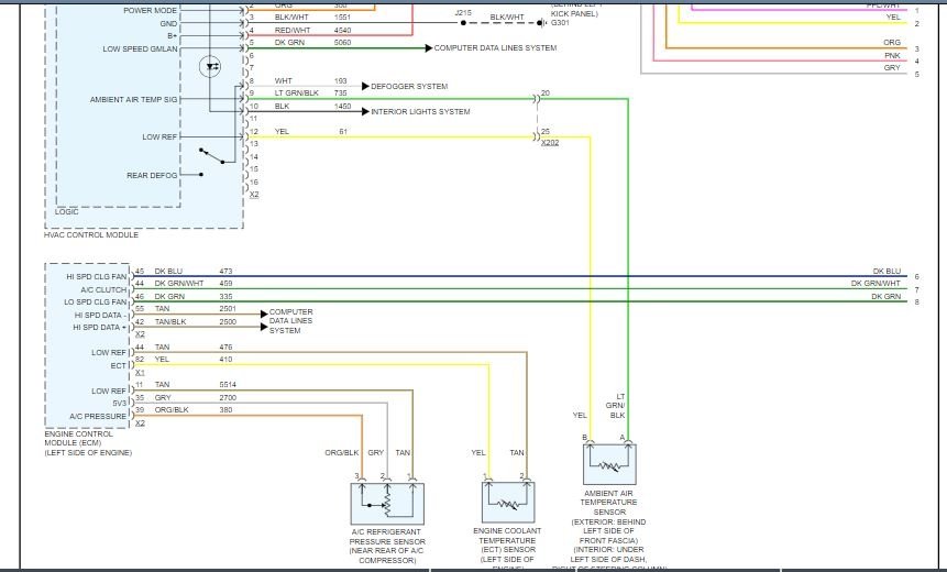

When I push the button to turn on front AC the light that should come on blinks three times and goes off. The heat still comes out of vents AC will not turn on. AC works in the back controls.
Jan 26, 2018 at 2:49 PM

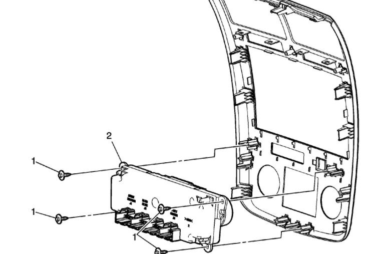

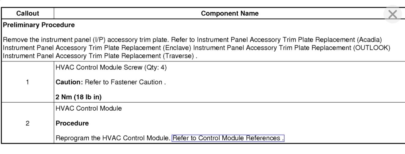

Do you have any gauges to check and see if there is any Freon in the AC system? the flashing lights may be an indication of low Freon. Okay, this sounds like the control head is the issue. If it was an issue with the compressor or any part of the control system, the rear A/C controls would not function.

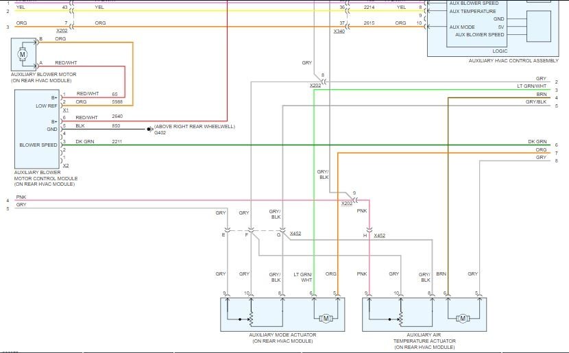

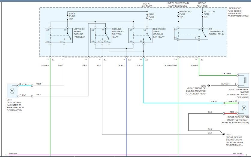

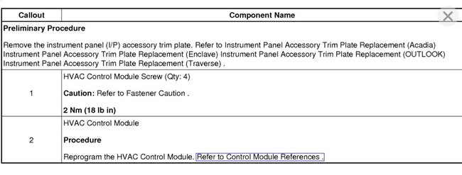

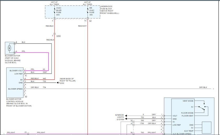

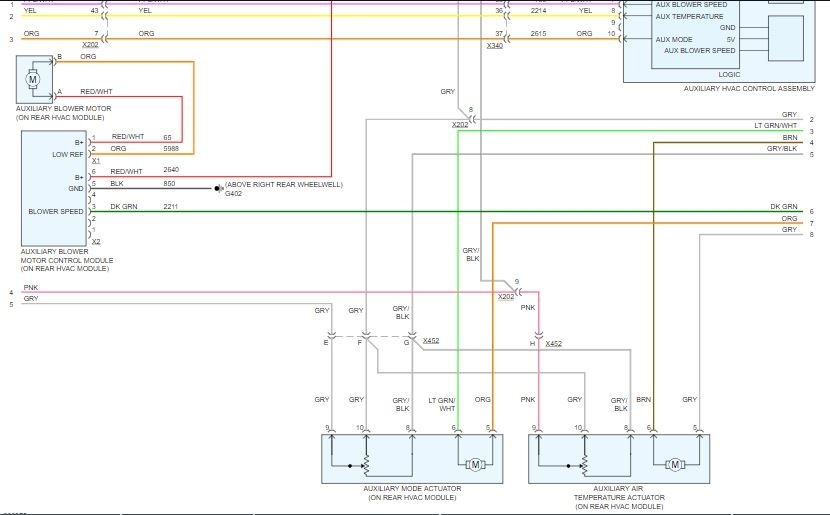

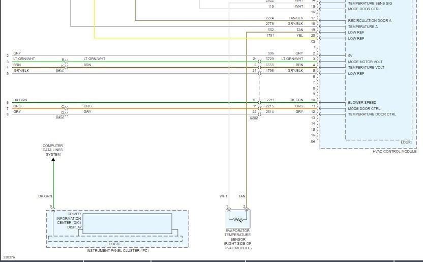

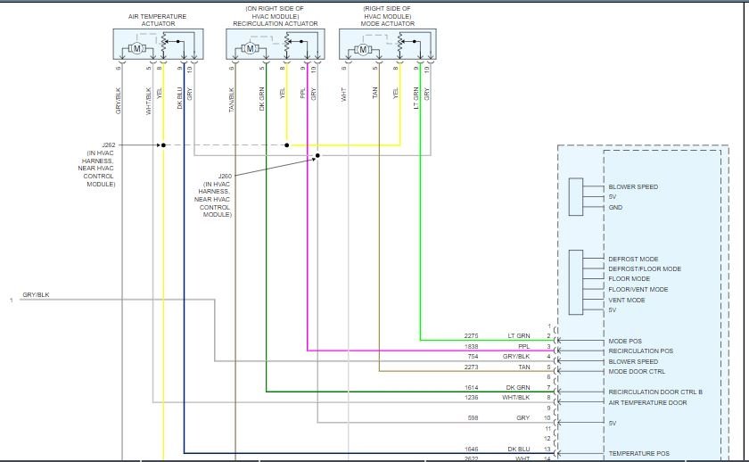

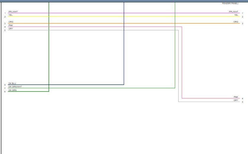

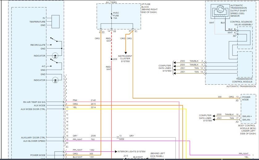

I attached the procedure for replacing the control head and a wiring diagram for the system. Check the fuses for power on both sides.
